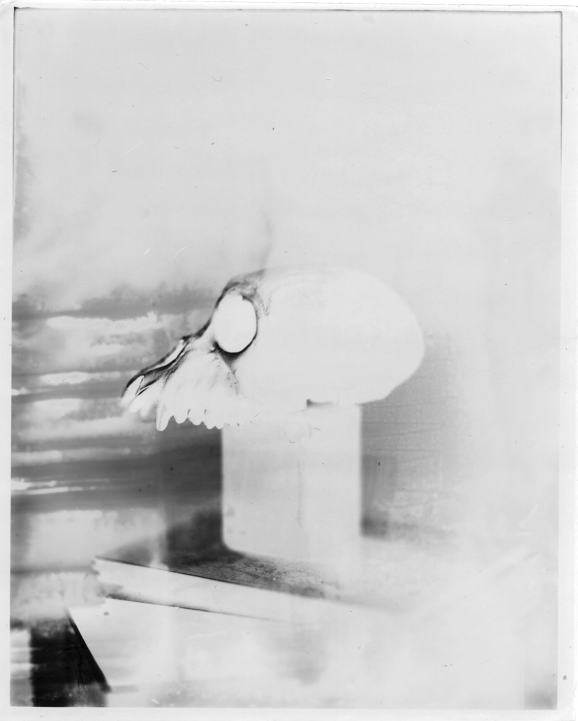

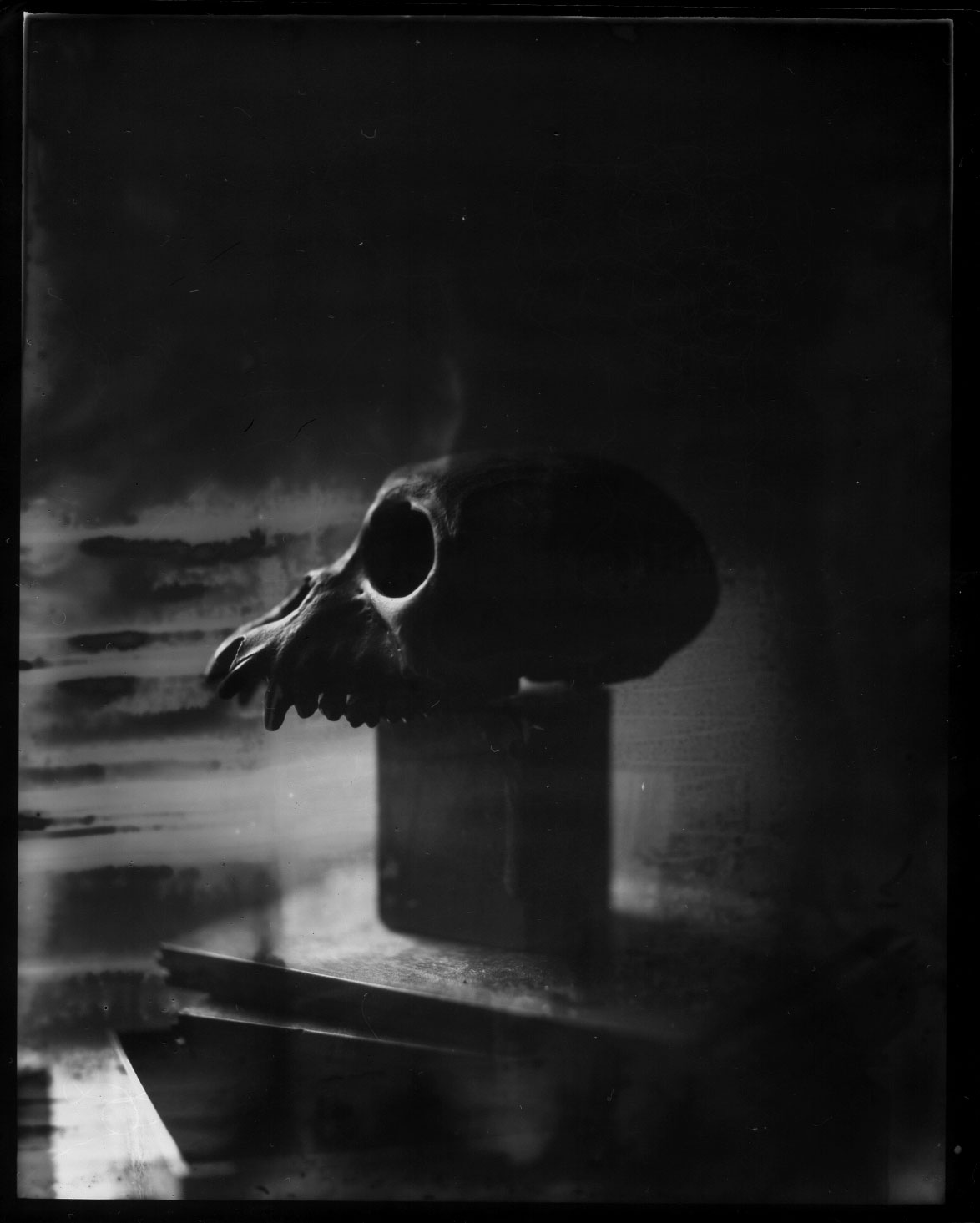

An experiment related to Mortensen's paper negative process in the resources, but in camera!
- I soaked some kentmere kenthene g2 expired in multigrade dev 1.9
- squeeged and placed in chamonix 4x5 wet plate holder
- then exposed for 10mins ev 6. f3 18cm Goerz hypar (projection) sinar P.
- In the darkroom I was a little disappointed as all I could see was the clear boarder from the holder and an indistinct image
- So placed it back in the dev (no longer following mortensens plan) and end up with a paper negative with some interesting artifacts from the dev soaked exposure.
For reference the skull is painted black and is on a black plinth on some black metal film holders.
The results are just quick scans
More tests required.....
