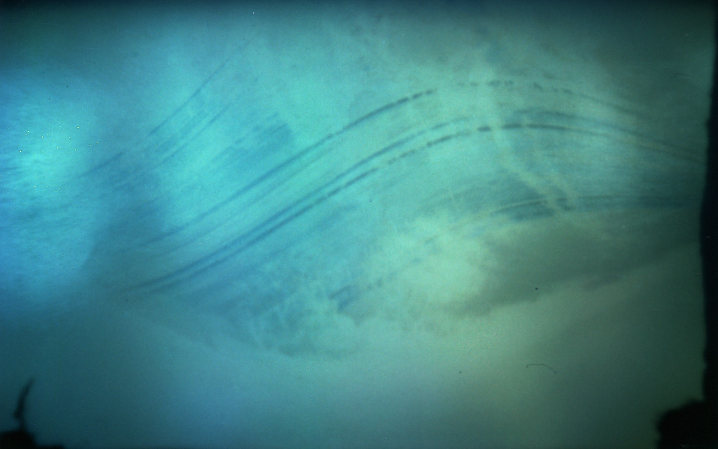

Step 1, I've worked out a way to fix solargraphs, so I did that. It involves a very very slight amount of development, followed by normal rapid fixer. Here's what we are starting with:
The background is just a bit lighter than this shows, but it is pretty close. The first thing I tried was a contact lumen print onto photo paper. You can probably guess what happened by the color... it was very effective at blocking the light. After 2 hours under a cfl there was an even light pink. So I put it under a UV BLB overnight, and only got a somewhat darker lavender-grey color, but no hint of any image. This background color blocks the light that photo paper is sensitive to just as well as the sun streaks.

Now we get to my wacko idea: I made a copy of the solargraph onto FP-100C instant film. For this experiment, I used my instant film pinhole camera to make the copy... maybe in the future I will use a lens:
That actually looks pretty neat in hand. It is a little greener than my scan shows, and it does not have so strong a brownish cast on the right. It looks like a solargraph underwater in a blue-green sea!

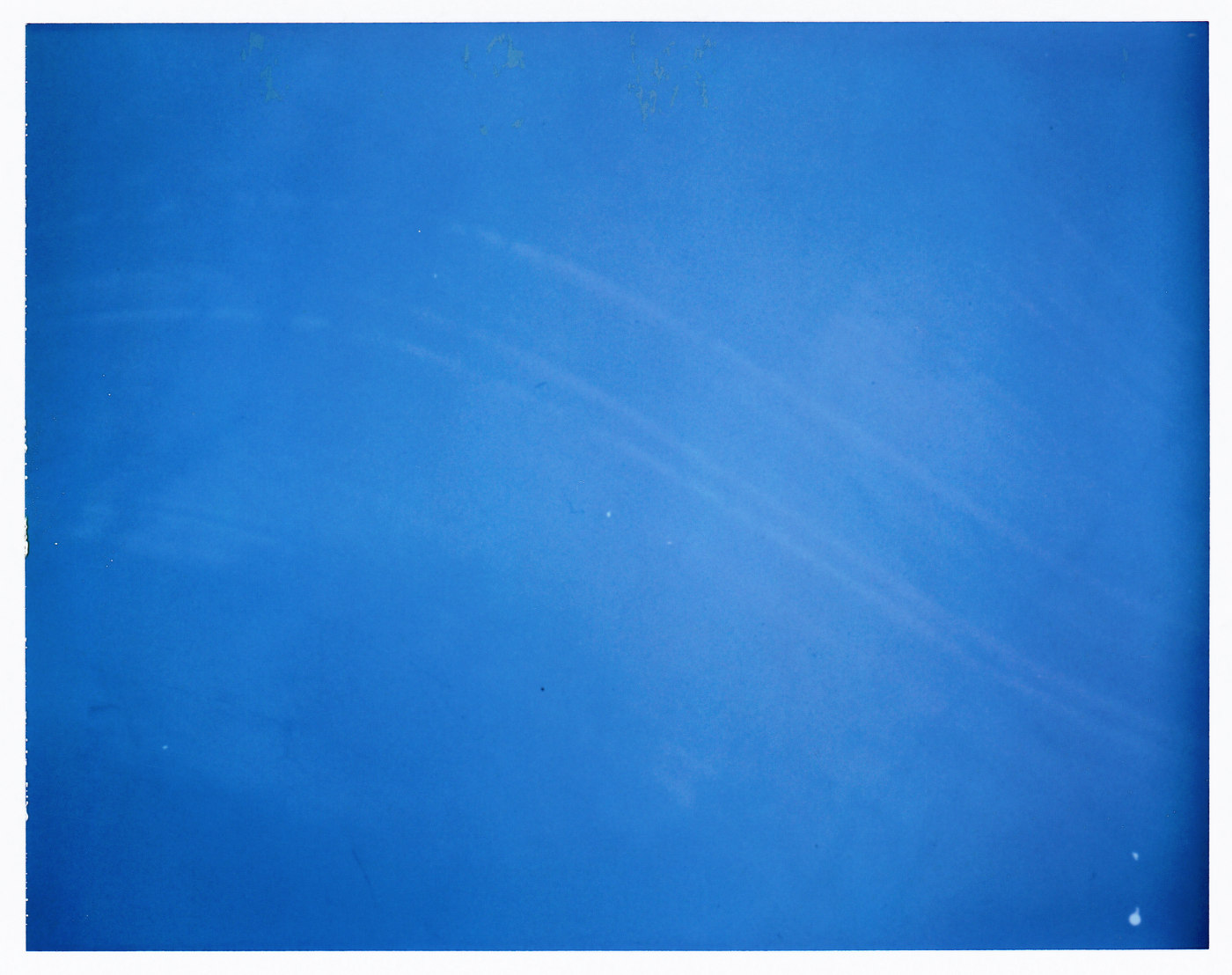

Next I "reclaimed" the negative ( which contains a positive of the solargraph ) by removing the "black goo" with bleach. This went well but the "negative" is a bit thin and low contrast. I put it into my enlarger and projected it directly onto a pack of FP-100C on my baseboard, hoping to transfer the positive image into something I can hold in my hand and legally upload to APUG. The result was not very good but it is a positive image:
It's maybe a little better than this scan shows, but not much.

The end result should be very similar to my scan #1 above. If you scan and invert this you will find all the detail still present, with a shift toward blues and browns after inverting the colors. But the solargraph will no longer need to be in a dark box. I have left some out on a sunny shelf for over 8 months with no detectable fading.
