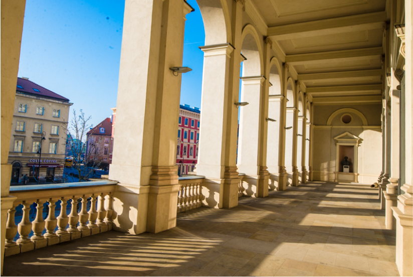

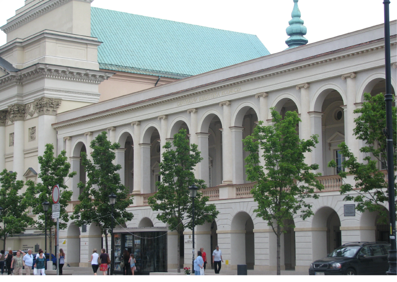

I tried this portrait experiment once before with Portra 400, handheld and a circular pol in bright sunlight on the coast near Porto in Portugal same type of people. here are three examples, the audience will be similar this weekend. I did also in the meantime manage also to get two shots of where this weekend's location is and it is south facing across a wide boulevard so even into the evening the sun will get through. See below.
My current thinking is, skip the circular polarizer , stand subjects by a column, using it to put them is the softer diffused light and get a 'volunteer to hold up above their head a collapsible circular bouncer I have that is silver one side and gold the other. and this time I will have a tripod so can happily use 160. try to shoot at f5.6 and have columns drift off behind subject to hint at grandeur of location.

This weekend's location in Warsaw,
