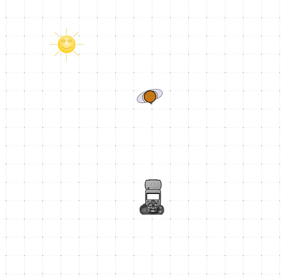

Ok, so I sent this photo to a friend of mine, of a person, on a beach.
I almost always photograph back-lit, and use a single flash on the person.
I set my exposure to match the ambient (usually max shutter at 1/200 on my Canon),
and I adjust the flash to match on the subject.
For this type of photography, I normally use a 580 EX II speedlight on-camera,
or a studio-flash with battery pack, usually on the camera axis, behind me.
The whole point of the flash, is to illuminate the shadow-side of the subject.
IE. as a fill-flash.
My friend, who is a real nerd when it comes to photography (perhaps not so good at applying his theories when it comes to taking actual photos, he seem to love the technical aspect and the gadgets more).
Well, he started this long discussion, which I thought was rather pointless, that my flash was not a fill light, it was the main-light.
I replied, diplomatically that, sure perhaps, but I use it as a fill, nothing more, it is not at an angle to shape anything, it is simply to illuminate, but I don't adjust my exposure to it, I adjust my exposure to the sun, which is the strongest light in the scene.

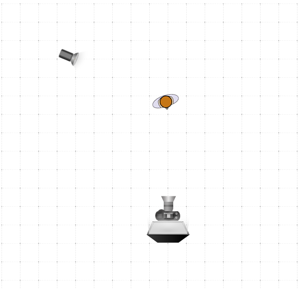

If I was to replicate the situation in the studio, I would have a flash replacing the sun, behind the subject, which would be the stronger light, to illuminate the scene and act as a kicker and one FILL on camera axis.
Like so
In my view, it is not more complicated than this.
But he insisted on this, there was no fill flash, there was a main light, nothing else.
So, even though it is completely useless and uninteresting, it annoys me.
I see the sun as the main-light, because I adjust my exposure to match that (it also act as a kicker on the subject).
Then I balance one flash, to lift the foreground shadow, which, in my world, has always been called a fill-flash.
So, for the guys who know more than me, what is the correct term to use?
Is my nerdy friend correct? :D:laugh:
I think it will be an open discussion...
It depends on definition. The main light is the light that predominantly lights the subject.
Here we got:
-) direct sunlight
-) indirect skylight
-) flashlight
In case the whole exposure idea was to make a silhoutte by the the sunlight, I would say sunlight.
If you would expose that much that the front has reasonable definition, and just do a fill-in for the face, I would say skylight.
If you flash the whole body to yield good definition, I would say flashligh.
On each point one may argue...
What does predominently mean?
What does subject mean?
Your main light is the brightest light, it doesn't matter where it is positioned.
It is the relationship between your lighting sourse that determins your lighting ratio, the main light being 1. eg. 2:1 the fill or second light is 1 f stop less than the main light.
Since you are shooting outside in full sunshine, I would think that the sun is your brightest light source (ok there may be occasions when this may not be so) so from your description I would say that the flash or any reflected light is the fill light.
But what if the brightest light does not reach the object or any of its surface in line of sight? (Or just indirectly, as from the sky, from the sand.) That is why I referred to the silhouette where the brightest light has an image forming effect by shadow giving.

The sun (well the kicker it creates) is almost always the strongest light in the scene (for me anyway).
Even if my studio-flash can overpower the sun, I keep the rim/kicker and balance the flash for rest of the subject, so that the kicker is about 1 stop brighter than the fill-flash.
In any scene, there will he reflected light from the "world", brightening even the subject's shadow side.
And for the whole thing to look natural, I strive to keep the light on the subject on par with the rest of the (sunlit) scene.
Sunlight on hair/chin and edges is more or less reflected, direct light, which is much stronger than the rest of the scene.

I think your friend needs to learn some basic photographic knowledge, especially about lighting and know that a little knowledge can be a dangerous thing.
BTW I am a professional photographer and have shot professionally since 1985.
Yes you are correct because no matter where the light source comes from, if it is the brightest, then it is the main light. Think of backlighting (contre jour as it was called when I learned photography) or film noir, they don't have the main light in the standard portrait lighting of 45 / 45 (45 degrees wide and 45 degrees high).
To think of it, studio or artificial lighting is trying to mimic daylight. The sun is taken as the main light (because in most cases it is the brightest) and all other lighting is to create the desired effect the photographer wished to create.
Like so

I think your "friend" is not correct unless your "fill" overpowers the sun and becomes the "main" light. In doing close-up photography of wildflowers, we tried to duplicate your lighting using a "backlight" as the main light and a light at the camera as a "fill" to get a more "natural" look to our photographs. Isn't a more "natural" look the object of most outdoor or even indoor portraits? Of course I am talking about a "natural' look. Maybe your friend is looking for something else.............Regards!
Traditionally, yes your flash would be the fill, since it's filling in the shadows. The sun is illuminating the majority of the scene, being the brightest light. So it would be the main light.
Though, to be fair to your friend, these aren't technical words with well established, formal definitions. It's not like there's a recognized photographic body that regulates terminology. The closest we have is probably the ISO, which I don't believe addresses this. Most of the terminology used in photography is developed and propagated by the photographic manufacturing industry, and our terms were more designed for marketability than clarity. Still, terms like main light and fill light are commonly used and commonly agreed upon by most photographers.
In any case, what does it even matter? It's just a bunch of names. What you call it doesn't change how it works or what it does.
