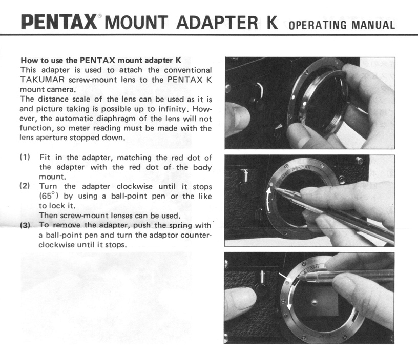

That's actually an eye-opener, thanks! I've managed to take the m42 adapter out of my ME Super, so I can use it now with the Porst.

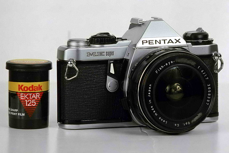

I've heard of the adapter getting stuck. Was it a Pentax branded one or other? I've used one to mount/unmount my Asahi Fisheye onto my ME Super without incident.
ME Super+Takumar Fisheye by Les DMess, on Flickr

My adapter looks original, I just didn't know how to take it out. I managed to remove it following choiliefan's instructions, but it is rather fiddly.
