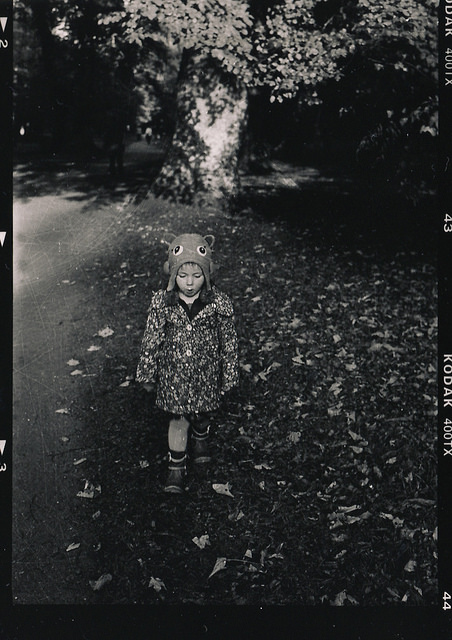

I was doing some contact printing yesterday for the first time. Quite enjoyable though I need work, bit rusty in the darkroom. I got some rough results that I'm happy with though, I'll probably refine a bit more and print 6x9 contacts masked in the middle of a sheet of 8x10.

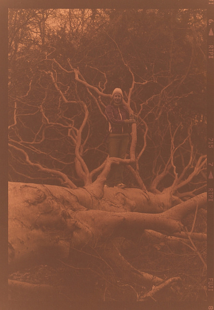

I had some B&W VC paper sitting around though which I'd used earlier to test and it was slowly beginning to print out over the day, so I stuck a colour negative on it and pointed an IKEA light directly at it from a distance of a few inches. Wasn't expecting much, just curiousity. I fixed it later on when I was doing the rest of the contact prints and it came up a bit. Here's a straight scan:
You can maybe already see what's confounded and confusticated me, it's clearer in the print, and clearer still if I level up the scan a little bit...
Where do the colours come from ??!? It's not just scanning artifact, the print has a clear green tone to her trousers, and blue to her jacket. It's a contact printed crossprocessed Fuji RTP negative, so could the dyes have bled onto the paper somehow or something ?

Silver halides are capable of producing several colors when exposed to light without development. The color depends on the size of the silver grains. The images cannot be fixed and so have limited practical value. Google on Lippmann plates such as http://en.wikipedia.org/wiki/Lippmann_plate
