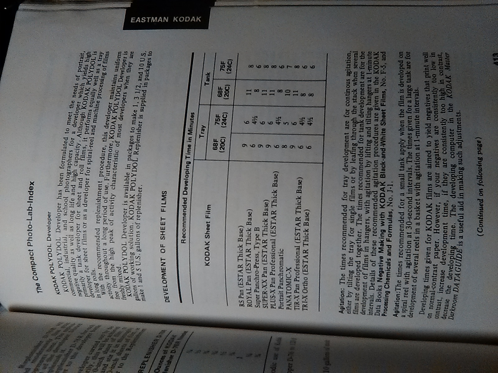

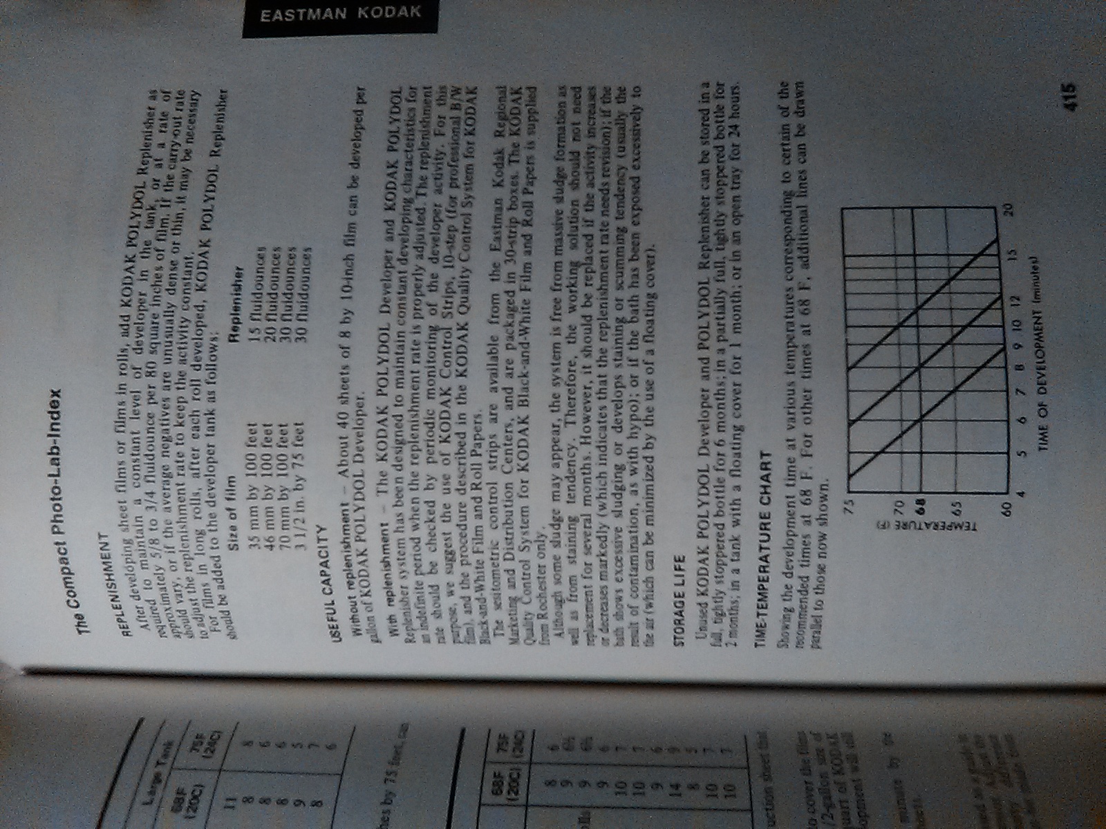

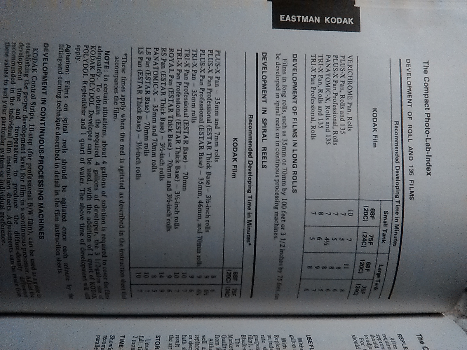

Sure. Here are some links regarding Polydol.
https://trademarks.justia.com/721/30/polydol-72130689.html
https://collections.museumvictoria.com.au/items/2186218
https://archive.org/details/aa143-PhotoLabIndexCompactEdition
Very interisting thank you much too by the way.
With regards
You're welcome. In one of those links I've shared, you can download The Compact Photo Lab Index for free in PDF. Every Kodak film in that book has times listed for Polydol among all of the other film developers. Those times are almost the identical times for D-76, but usually 30 seconds longer. ALSO, you can dilute Kodak Polydol Replinisher 1:1 and use it as a developer as Kodak recommended this for tanks holding 4 gallons, as their packaged developers made 1, 3½ and 10 gallons, in order to top it off to capacity with no change in their processing times. So, a 1 gallon can/package of Polydol Replinisher actually makes 2 gallons of Polydol Developer! I've tried this and IT WORKS!
The Compact Photo Lab Index also has formulas and instructions for Ansco/GAF, Ilford, Ansco, Edwal and many other hard to find chemistries and info. It's a serious film photographer and the darkroom enthusiast's best friend!
Werewolfman, you are a champion! I have long wanted a version of the Photo Lab Index as a reference tool - back in the days when I was younger and more into experimental darkroom work (I'm now returning to this in my retirememt), I had several copies of the original books, but in one of my (many) moves at the time they were lost and I haven't been able to replace them here in Australia.
All of 724 pages to peruse, oh my...!

Thank you! I'm glad to have resurrected past photo techniques and formulas, along with my 41 years of knowledge in using these various products and processes. If there are any more questions, please feel free to ask me, and I'll do my best to answer them..
