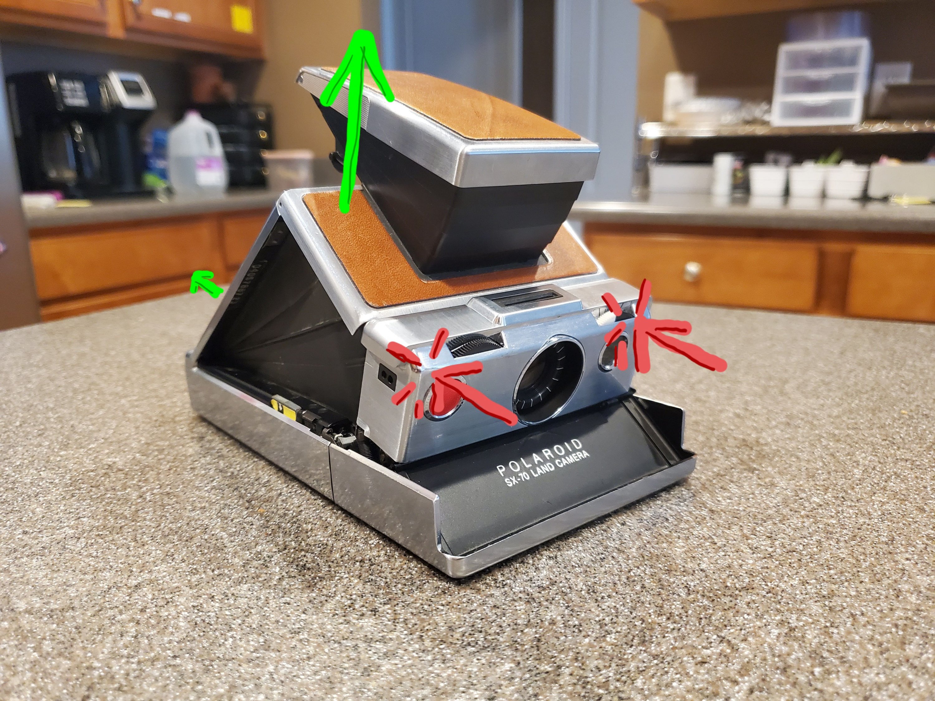

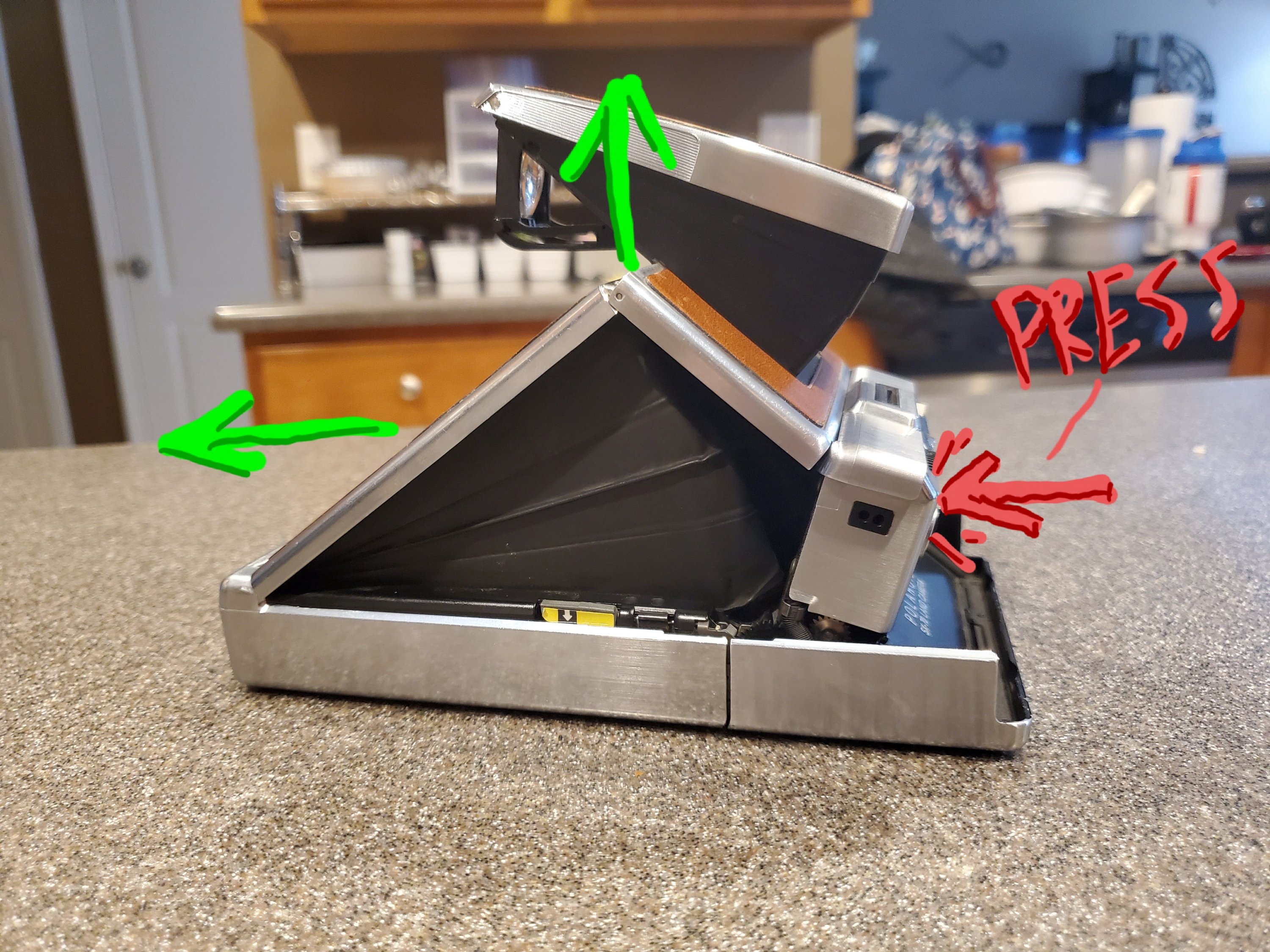

Hello, I recently purchased an SX-70 with the same problems as described above. I am not sure why this works, but I press on the front of the camera (red arrows) to essentially move the camera (green arrows) into a more "open" position. I press until I hear a little click, then I fire off a round; out comes a frame no problem. This might not work for everyone, but it works most of the time for me and hopefully you too. Good luck :smile:
That sounds like the switch that detects the camera being fully open is out of adjustment -- pressing the lens board that direction will open the camera that little bit more and actuate the switch, allowing the camera to fire.

If I don't make sure the metal support leg (on the left side of the camera) has clicked fully into position, the print has issues ejecting.
