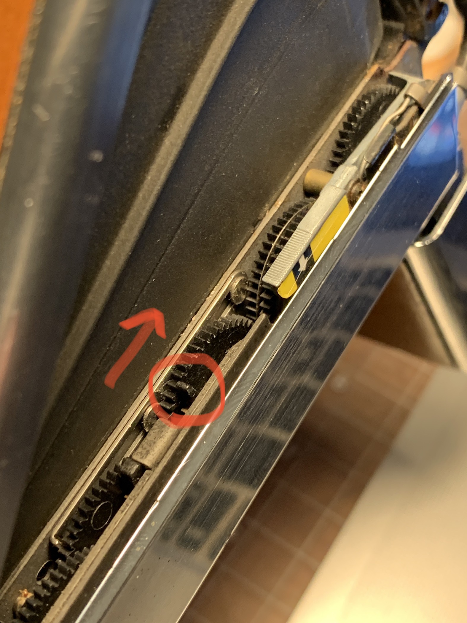

So somewhat positive development: I was able to trip the motor into operating by nudging this nub forward. It still wont do it on its own though- I have to nudge each time and it also wont stop unless film door opened.
Looking into it more-- found a repair manual online-- but if theres an easy fix here, let me know.

After doing more digging, the issue now sounds like a broken motor/gear train coupler and an out of adjustment S3 switch. Gonna take a closer look later
Alright-- in the home stretch. Can anyone help me understand how the heck the switches associated with the frame counter work? Thats the last step to a working camera-- if manually contact the switch (S8), it will initiate the dark slide sequence.
It looks as though a little arm beneath the ribbon cable that keeps the counter from resetting itself is having trouble engaging
