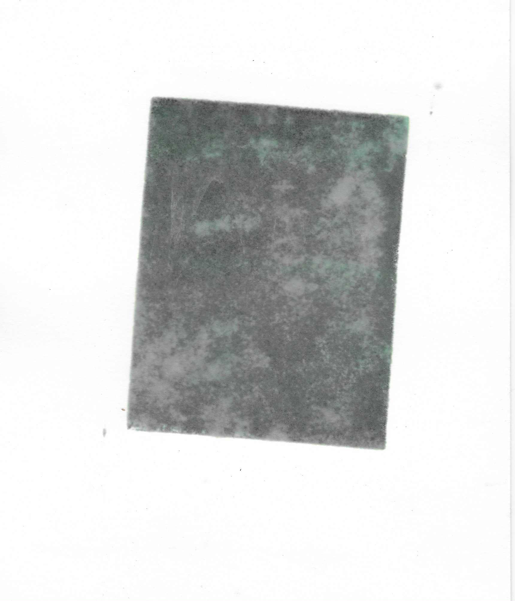

I've never tried transfers (not emulsion lifts) but maybe I could use some of these films to try that?
So I tried following the instructions in Kathleen Carr's book 'Polaroid Transfers;'.
All I got was a dark green square - several variations.
I can see an image on the negative in a glancing light but no positive transfer.

The 2 test images were taken to see whether the film pack was still viable (not dried out) and it looks like that's not the problem (ignore colour casts - that comes from casual meter reading and lighting).
I was trying to make transfers onto damp paper (soaked and squeegeed) and was mindful of using a tray-warmer to keep the temperature around the 30°Celsius mark.
What I actually achieved is shown below in image 3 - several variations.

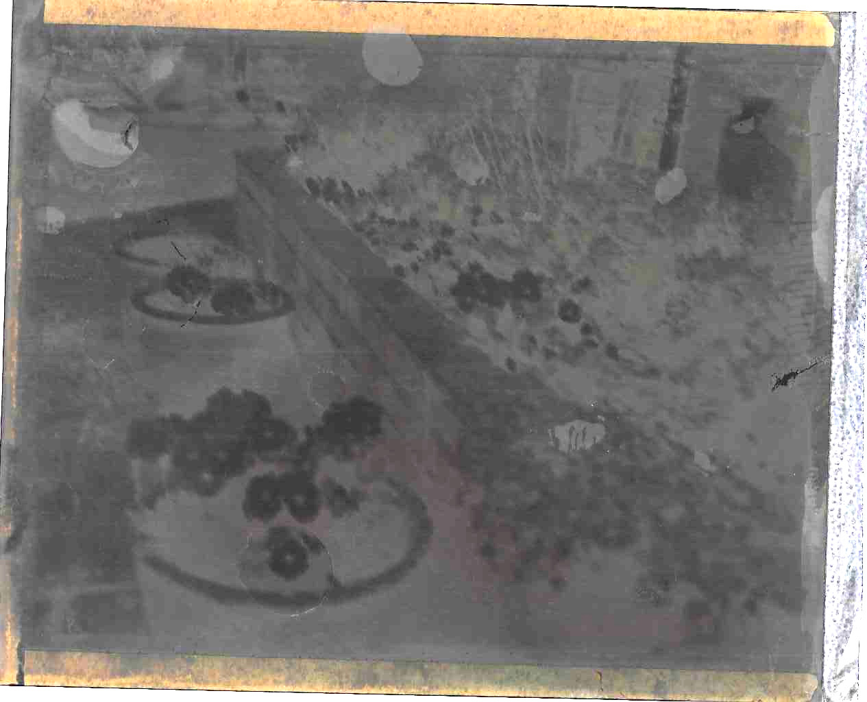

I've scanned the negative of one of these failures - image 5 - so something is being produced on the negative but not transferring. The contrast is poorer in reality but my scanner insists on 'improving' the picture,
