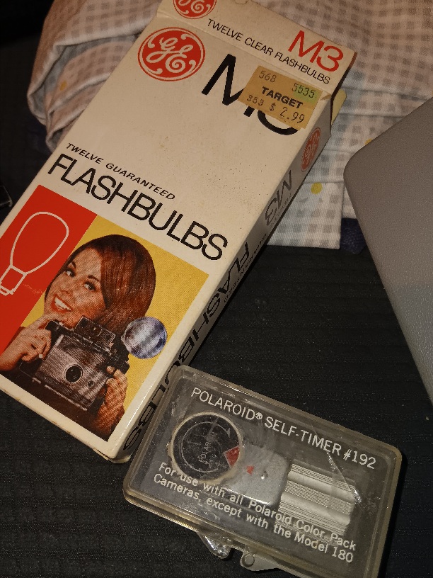

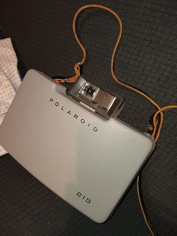

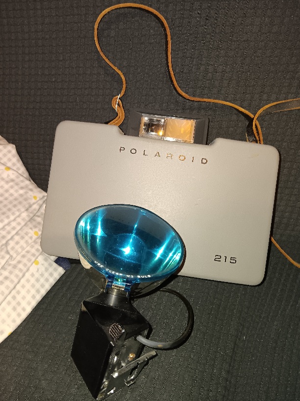

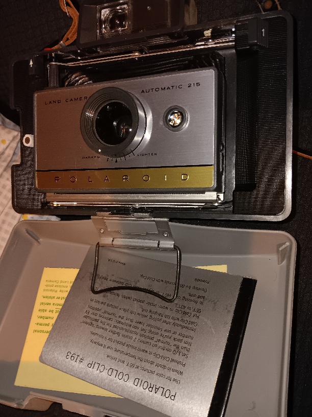

Anyone know anything about a Polaroid Automatic 215 land camera?? I came across one today in perfect condition and I'm trying to find out more about it! I tried loading photos but it says they are too large
There we go! Had to resize the photos đź’Ą
Uses peel-apart film like Fuji FP100C, which has not been made in too-many-years-to-buy-some (you can buy some old packs, if you want to spend a lot of money). And Polaroid branded peel-apart hasn't been made in 20 years (I think?).
So that camera is a paperweight. It also uses a battery you can't buy - you'd need to adapt something else to power it's automatic exposure shutter.
Being an automatic it's not as useful as a manual one. If you have something like the model 150 you can put a sheet of 4x5 in there and make the shot.

With a battery, it can expose single sheets of film put in the back. That's about it, without doing something drastic to the camera. I'm sure someone could hack a roll-film holder into the back of it. For the most part, though, there's no good reason to do those things. The lenses were not exceptional, since the idea was the photo would never be bigger than the 3x4 instant film it used.
You kit is in very nice condition, so it has that going for it. Check to see if there's a battery leaking away in the holder - you'd probably want to get rid of that.

The exposure control on the automatic Polaroid cameras like this one was rather sketchy and finicky.
I do have for display 2 boxes of the old roll film, expired 1963. The black and white is listed as ASA 3000 the color insert has the speed as ASA 75.
Black and white in ISO 100 and 400 came along during the pack film era. The higher end pack film cameras accommodated all of those speeds, some of the lower end ones only had 75/100 and 3000.
The 215 is one of the low end pack film cameras with a 2 element plastic lens and only 2 apertures: f/8.8 and f/45. The plastic lens is surprisingly sharp but is not as good as the 3 element glass lenses in other models such as the 250. The biggest downside of the 215 is the "imagesizer" viewfinder, which connects the focusing mechanism with an arrow that points to a distance scale in the viewfinder. At f/8.8, it is quite difficult to achieve accurate focus with this system. Most other pack cameras have a split image rangefinder which works well at achieving accurate focus.
Pack cameras can be modified to use a variety of film formats such as Instax wide, Polaroid i-type, 120 6x6 and 6x9 format, 100mm wide 35mm panorama, 3x4 sheet film in film holders, as well as 4x5 with some vignetting. They can also be modified to use manual shutter speeds. Files and instructions are at http://polaroids.theskeltons.org/conversions.htm
