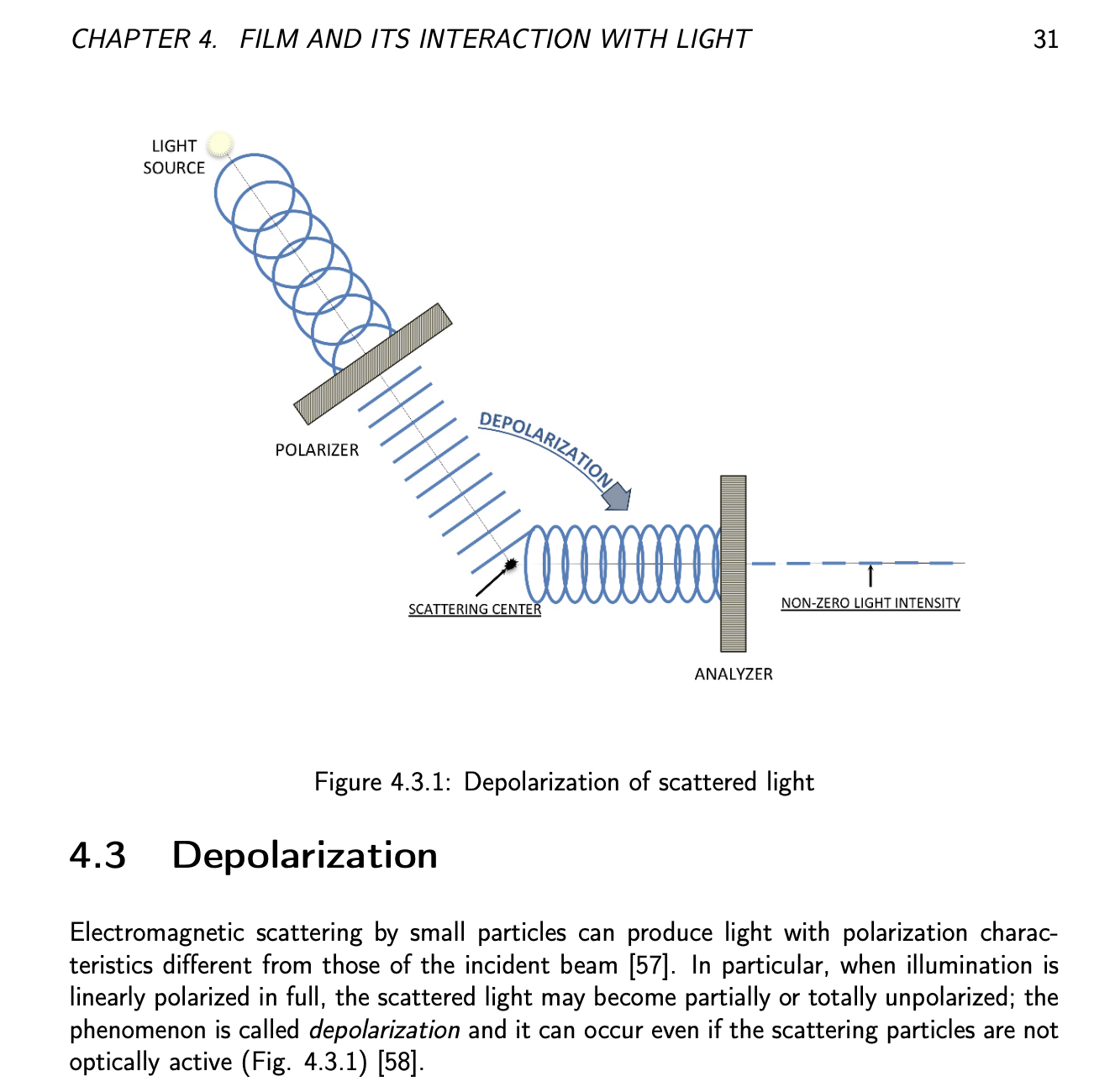

Several years have passed without new contributions to this thread, and I can tell you that the use of polarized light combined with a polarizing filter for black and white enlargements was a common practice in the commercial laboratories that Agfa-Gevaert had in Buenos Aires. Fixed gradation papers were used (not variable contrast) and the contrast of very contrasted negatives was diminished by attenuating them a little with the polarizing filter. This is because the denser parts of the negative maintain the colloidal properties of the photographic emulsion and slightly depolarize the light that passes through them, while the lighter parts do not. By slightly blocking the passage of polarized light with the filter, differential control is gained over the light passing through the shadows and highlights.

Basic physics tells us that polarized light can become de-polarized when scattered by the emulsion, but not necessarily the other way around.
The article you posted gives an example of how polarized light can be partially depolarized by scattering, but it says nothing about whether unpolarized light can become partially polarized by scattering. In fact, scattering often does polarize light: this is why reflections off some surfaces are polarized. The amount of polarization depends on the dielectric properties of the scattering medium. For example, https://sciencedemonstrations.fas.harvard.edu/presentations/polarization-scattering
I don't know, of course, whether scattering in the film emulsion was the real effect that the OP's master printer was trying to control with the polarizer. Printing (especially, I imagine, printing at very large sizes) is a craft that has a lot of empirically derived practices that should be physically justifiable after the fact, but aren't easy to deduce from theory in the absence of practice.
That is a fish tank not film. The reference I posted referred to effects of light scatter on photography film, though the fish tank experiment may also hold for film. Someone should put a polarizer on an enlarger and show the images to see what it does.

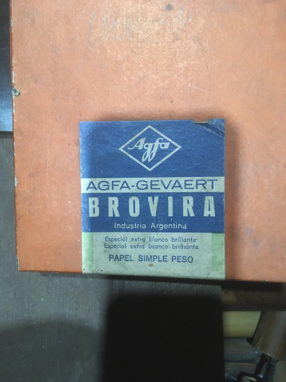

When was this? Was this for printing smaller negatives like 35mm, 4x4 cm , 6x6 etc or large format? A lot of this knowledge is gone. Welcome to Photrio!!!
I guess anakhan is referring to the 50's and 60's when agfa manufactured photographic paper as did ferrania in Argentina. As for the type of film, in which this method was used, I don't think it was LF. It was almost non-existent in Buenos Aires.
As for the lost knowledge is a great truth, it is very difficult for me to get my father and his brothers to remember their methods, after 30 years that they left the profession.
Photo of a box of Agfa Argentina photographic paper of the time.
