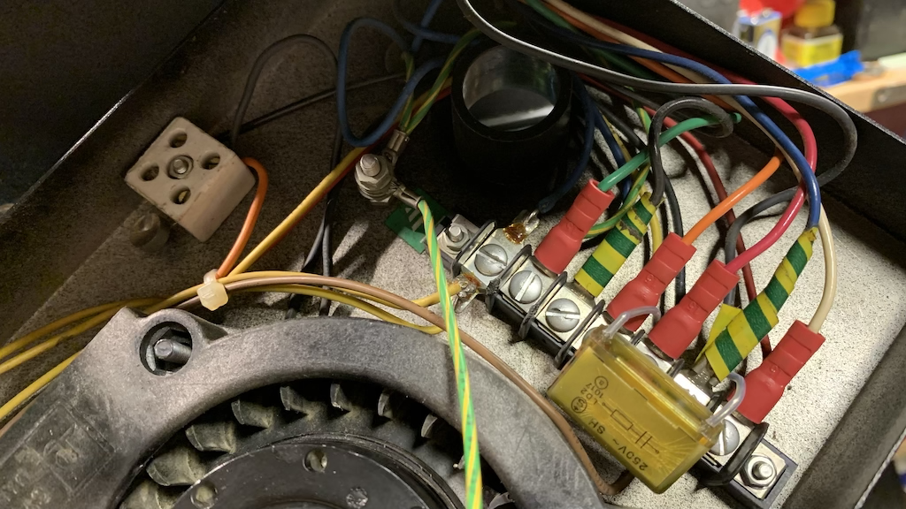

For what it's worth, the fan on the 500 head I used to have was always on. Never noticed any trouble because of it, apart from it being noisy.
reading, in the web and with participation of users they commented that the first models the ventilator worked continuously, in the newest models the ventilator cut after 2 minutes, in fact my equipment as soon as I bought it in 2 minutes it cut... I believe that my case, it stopped working the cut thermic. there is a way that is to add a new term, it is necessary to make adaptations.
George Nova Scotia
Mar 17, 2010
997
Milford, Nova Scotia
going from memory, the fan time out is controlled by a chip on the board in the power supply. Last time I checked the chip was no longer available in the same package (DIP) but was available in newer formats. With adapter boards it could be made to work if you can't live with it running all the time. Not a trivial job but not hard with the right tools. If you need schematics let me know. There are at least three versions of that board.
Rmaydana
Rmaydana
Sep 8, 2017
132
Asuncion
thank you very much for your comments, I am already interested in solving the fan issue, not so much for the noise. As I spend 6 hours a day in the darkroom, my fear is that it will stop working. I attach a picture of the box that is above the lamps in the head of the enlarger.
