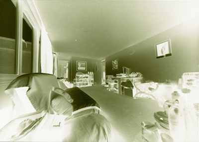

There we go, I'm no longer a Pyro Virgin :D
I wasn't very brave so I processed a Shanghai GP3 120 done with a pinhole camera -- chicken ! :D
+ prewashed 2 minutes (the shanghai is very colorful!)
+ 10 minutes in + PMK with one agitation every 15 seconds
+ then 2 bath of water instead of my usual stop bath (not sure if the stop bath is "bad" or just "not necessary")
+ then 5 minutes in Ilford Rapid Fixer
+ then 20 minutes in water, with replacement every 5 minutes or so (tap water is too cold, I felt)
The negs are not dry, but they look "good" from here. Fun the stain ! First time I see a pyro neg too :D
RAP
Nov 28, 2002
476
buze,
Is Ilford Rapid Fixer a non hardening, non acid? I would check to see if it is. If so, you lost your stain. Pyro developers only stain in non acid fixers like tf-4 from Photographer's Formulary.
buze
Aug 31, 2006
179
Windsor, UK
Well I know it's non-hardening; non acid I'm not entirely sure...
Here is a color scan of one of the negative :
And the resulting direct positive:
I noticed that there are dark spot/blotches in the highlights.. I'm reasonably certain it's not the ceiling that is dirty :D
The grain is next to inexistent, but these tiny dark blotches will surely show in a print... I know it's cheap film, but it's "clean" in other developers (DD-X and Barry's 2 bath)
