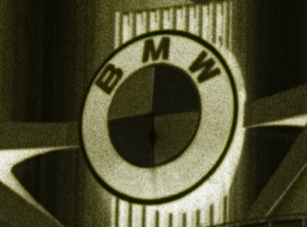

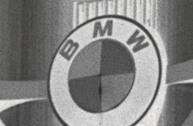

Here is a crop of a FP4+ negative scanned as a colour slide. If I have understood the concept of a pyro developer correctly, I would expect to see a yellow/green/brown stain, which is denser around the exposed (darker) areas, but there simply is absolutely nothing there:
The faint color of the stain that you show is much the same as what I get with Delta 100 in Pyrocat HD.

I don't know which colour you are referring to here. Do you see anything I can't see or measure? If you are talking about the scan I posted, it does not contain any colour information consistent with what the staining effect of a pyro developer is supposed to do. If I remove the luminance and amplify the chrominance as much as I can, there are some colour patches on the image, but it seems as if very bright and very dark tones have a blue colour cast, while midtones have a red colour cast. That can be explained by deviations in the scanner's sensitivity curves for RGB light, but not by a pyro inflicted staining of the denser areas.

I tried to develop another strip of FP4+ today without adding amidol to the Bergger PMK developer. I now have a very obvious green and yellow stain to the negative, just as it is supposed to be. I will do another attempt with properly weighed amidol, but it seems that adding too much amidol to the PMK developer prevents the stain from emerging.

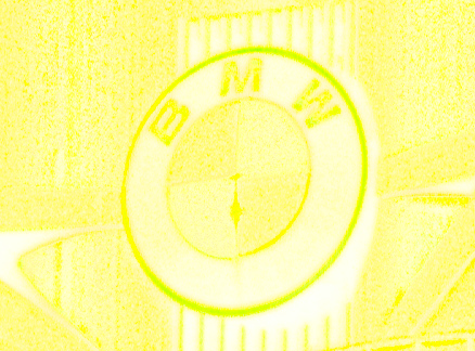

When scanning the negative as a color slide film (white balance is set to the film base between exposures), there is already a very clear colour cast to the scan:

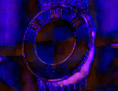

Removing the luminance and just keeping the chrominance of the image also reveals that the density of the stain, at least to a certain degree, correlates with the density of the silver image:

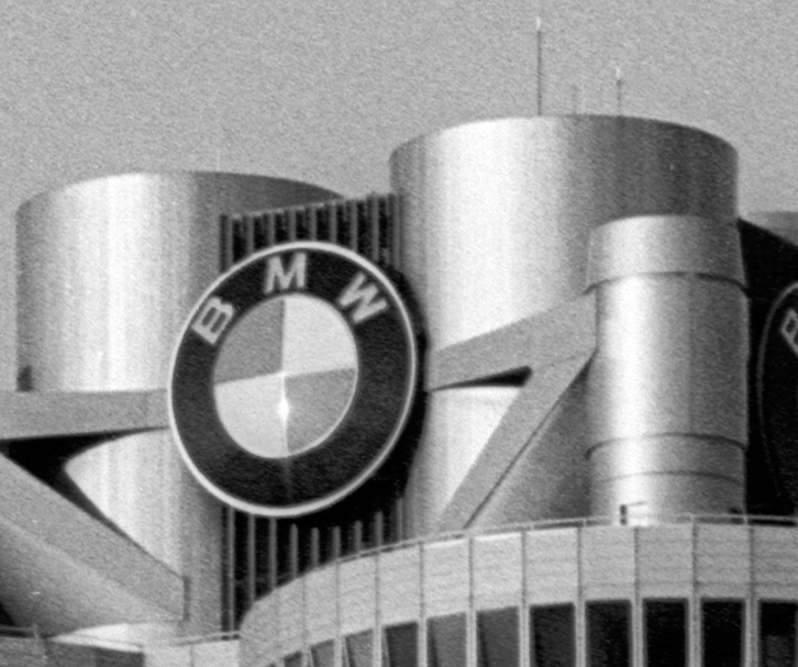

For those who are interested, here the full image and a properly inverted crop of the logo above:
