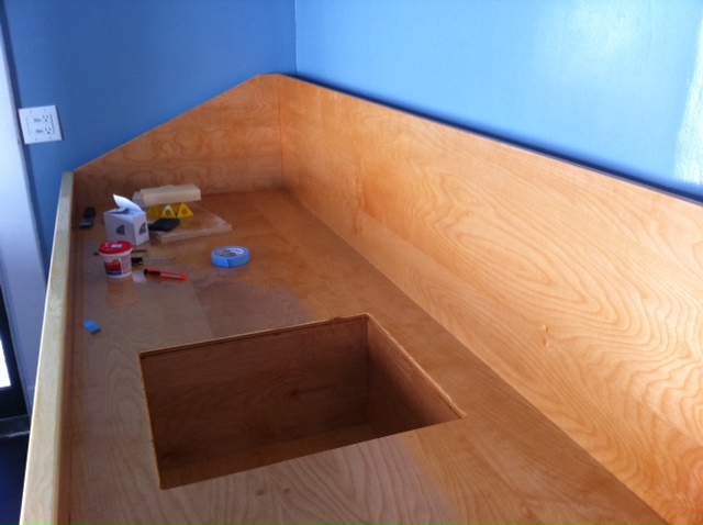

epoxy is best applied to raw wood. I'd remove the caulk, lot's of things don't stick to it and it's not needed if your coating is waterproof. You didn't use birch ply which is more stable but you don't need to coat both sides. Just paint the outside. My first sink was slightly smaller than yours and the links I provided were enough to do 2 coats, maybe I did three. Several coats with a brush to the joints. The nice thing is you can buy powder to mix with the epoxy to die it. Defender sells that as well. My latest sink is 8ft x 30 inches and 18in deep at the back with a drop down basin. I bought the large .98 gal can of epoxy and did three coats with a foam roller (not the right roller cuz it left bubbles). The cans don't feel like I used that much but doing light coats with a roller uses less than sloppying it on with a brush. Those bubbles can be eliminated with a propane torch (manufacturer recommended) if you go over the surface before it sets up. I mix the resin in a beer can with the top cut out.

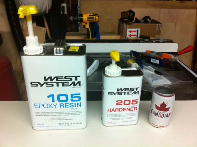

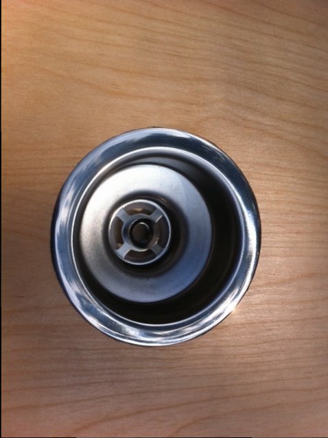

Here's some attached pics of my new sink in my new darkroom. Whoever buys my house when I die is getting a sink because I assembled it in place and I'm pretty sure it's an inch wider/deeper than the door. The drain is epoxied in place after being routed out so it would sit flush.

Nice carpentry...........it's out of my scope of desire for my darkroom sink, but the birch veneer makes it look so clean, nice job. My drain hole is also routed for a flush mount drain.
