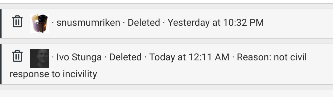

Note to mods and @snusmumriken - I was calling myself illiterate (in scanners) - which I am, therefore I have to rely on a side-by-side comparison instead.
The formulation of your post didn't make that explicit, so I think that was why it was binned. Don't worry about it, but keep in mind that when using terms like 'illiterate' this way, there's a chance people will misunderstand even if you mean well.
Yes, I already understood most of what Puts wrote there (and he managed not to mention Leica once, although the red and black text is a bit suggestive!)
What I haven’t completely grasped is how a scanner operating at low resolution creates a noise pattern that is irregular like graininess, and presumably founded on the same grain clumping, but coarser and less distinct than what you see optically.
@Ivo Stunga This incivility thing has passed me by, and I don’t know how I am implicated. I hope I haven’t inadvertently caused offence somewhere?
Yeah, it was in the context of my previous post, therefore easy to misunderstand.

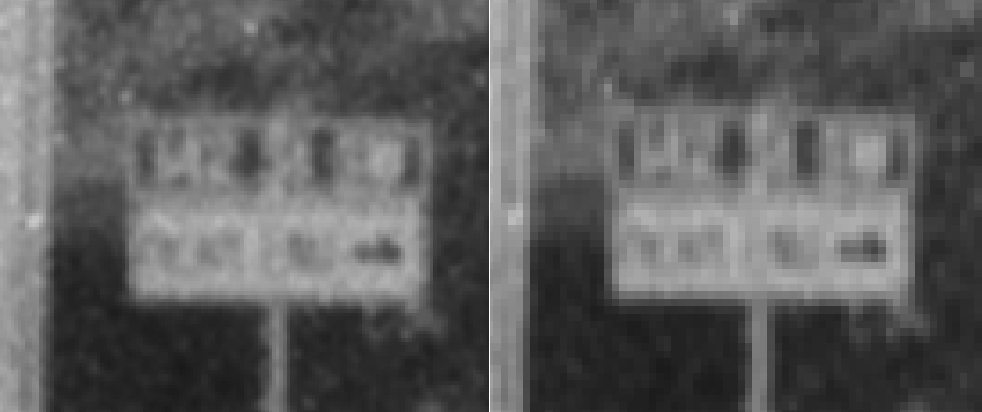

Here's a comparison of 7200 vs 3600 DPI on a Plustek 8200. Left to right respectively.
Adox HR-50, HR-DEV, Olympus 35 RC
Not the sharpest camera around, but I can see some details missing. For example, in the "4" in 142 I can almost make out the space inside.
I used the "Less Auto Sharpening" setting under Unsharp Mask.
Full text reads "142 ST SW, DEAD END -->".
For my work, it's not quite enough gain in detail to scan everything at 7200 DPI (with 4x file sizes). But I feel more detail is to be had. The "4200" or so DPI guess made by others bears some consideration.
Somehow, all I see is huge pixels. I can't read any text in any of the images. Am I the only one?
If you zoom back out, it becomes (sort of) visible:
I'm not convinced there's actual information gain going from the 3600dpi to the 7200dpi scan. There are more pixels, but it seems to be a combination of interpolation a lower s/n ratio.
Emphasis on 'almost' - you can 'almost' make it out if you already know it's there.
Whatever additional information is actually captured, is so little that its benefit is IMO marginal at best.
