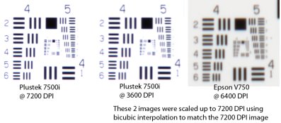

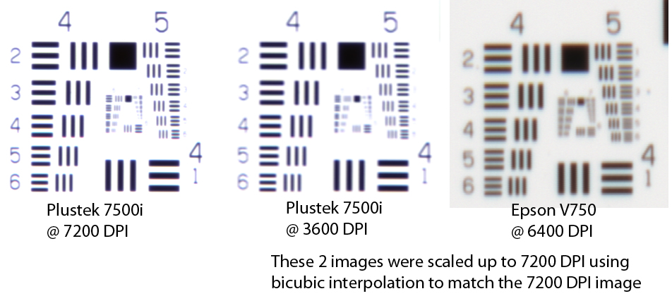

I'll just leave this right here...
All scans are straight scans, no sharpening. These are from the Plustek 7500...not sure what the exact differences are.
Even scanning at 3600 DPI, the Plustek outresolves the Epson, IMO.
If you can live with the limitations of the Plustek (no AF, no multi-sampling (?), manual film feed/frame advance), it's a decent scanner for the price. Silverfast SE has some limitations, you may want to evaluate VueScan to see if it would work better for you.
Ooops...just checked, the 7400 is only 3600 DPI hardware, so ignore the 7200 dpi scan. I would guess the 7400's 3600 DPI is close to the 7500's, but maybe not.
Hope that helps...

Greg,
Thanks for taking the time to post that. I think I might just bite the bullet and go for it with the Plustek. Everything I've seen thus far points to it being far better for my usage than the Epson.
I have no illusions that it will be on par with a Nikon Coolscan or an Imacon, and realistically I don't see myself spending $2k on a scanner anytime soon. I think with those expectations being in mind I will probably be pleased with the 7400.

I think the Plusteks get a bit of of a bad rap, largely due to lack of features (as I mentioned in my first post), but IQ-wise they're quite good, as you can see.
Re: Vancouver...small, indeed, if you were to know my address! Depending on how long ago you lived here, you might not recognize the place.
Best of luck with the new scanner.
--Greg

Greg, Mark from Plustek here. That's a good series of images. The 7xxx series and 8xxx series have 7200 dpi sensors. There is no hardware interpolation to get 7200 dpi on any of our scanners. However, all scanners are somewhat limited by their optics so that's why you won't see a 7200 dpi scan resolve 7200 lpi or dpi. The 7500 and the newer 7600i series do use different sensors but the resolution results are similar. I just measured the 7600i that I have in my office and got almost identical results to yours.
Hi, Mark, welcome to DPUG. Thanks for the clarification on the resolution specs. B&H has the specs for the 7400 as 3600 dpi hardware/7200 dpi interpolated. I should have checked Plustek's site directly.
