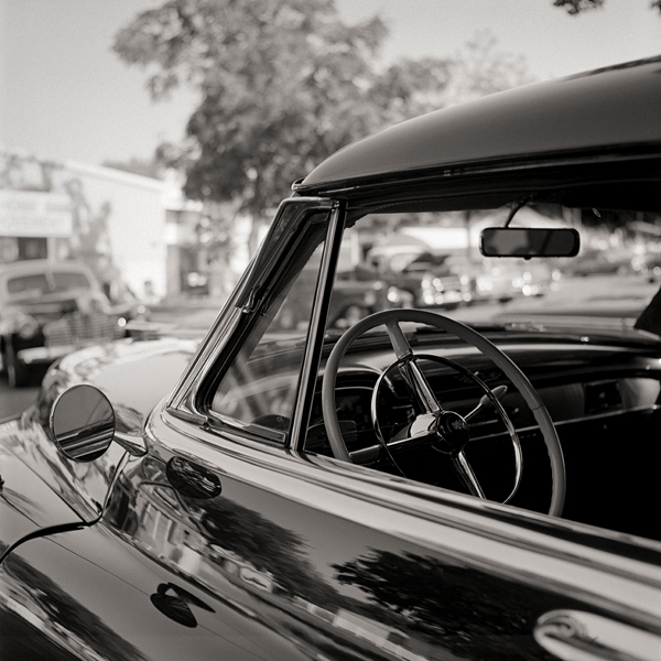

Attached picture is from REALLY high contrast with parts of the scene in full shadow and other parts in full blazing sun, in the middle of the day. FP4 or Plus-X? I have used both extensively and still have to look up what film I used to be able to tell in my prints. I have no idea which this one is, and would have to find the roll of film to be able to tell.
- Thomas
(This is a work print from 2009 on selenium toned Ilford warmtone / Ethol LPD).

That's real perty, Thomas, as we say in Texas. Thanks for the example. I'm always a bit skeptical of the broader statements about one film's differences from another, esp when they are of the same class of emulsion.
Thomas,
That's very, very well rendered technically. My first impression? That if I reached out and touched my monitor, I risked smudging the finish on the car. And I certainly wouldn't want to take my monitor out in the rain for the same reason...
