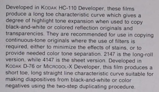

But, Lachlan, the official published curves I was just viewing a day or two ago were specifically for BOTH 2127 and 4147, and done in 76, and showed a rather long toe. How do you explain that? In fact, it's the same set of curves you linked in the duplicating manual (which I also own). That is a long toe. Period. Just compare it to the Super-XX page. This is all academic of course, since both of those films are now obsolete.
All the published curves in data sheet F8 and the duplicating manual for 4127/2147 are for HC-110 (dilution B), I have appended the commentary from the duplicating manual regarding 4147/2147 which very clearly states Kodak's position on the curve characteristics.
As for D-76, it is more than capable of handling all sorts of lab/ technical/ separation/ duplicating uses - DK-50/ DK-60a/ HC-110 were preferred industrially for various reasons, but you should not draw simple conclusions that D-76 is bad for any of these applications, especially not in small scale use.

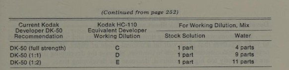

HC-110 as a substitute for DK-50 giving similar results.
Dilution C = DK-50, stock
Dilution D = DK-50, 1+1
Dilution E = DK-50, 1+2
A & B are DK-60a stock/ 1+1
