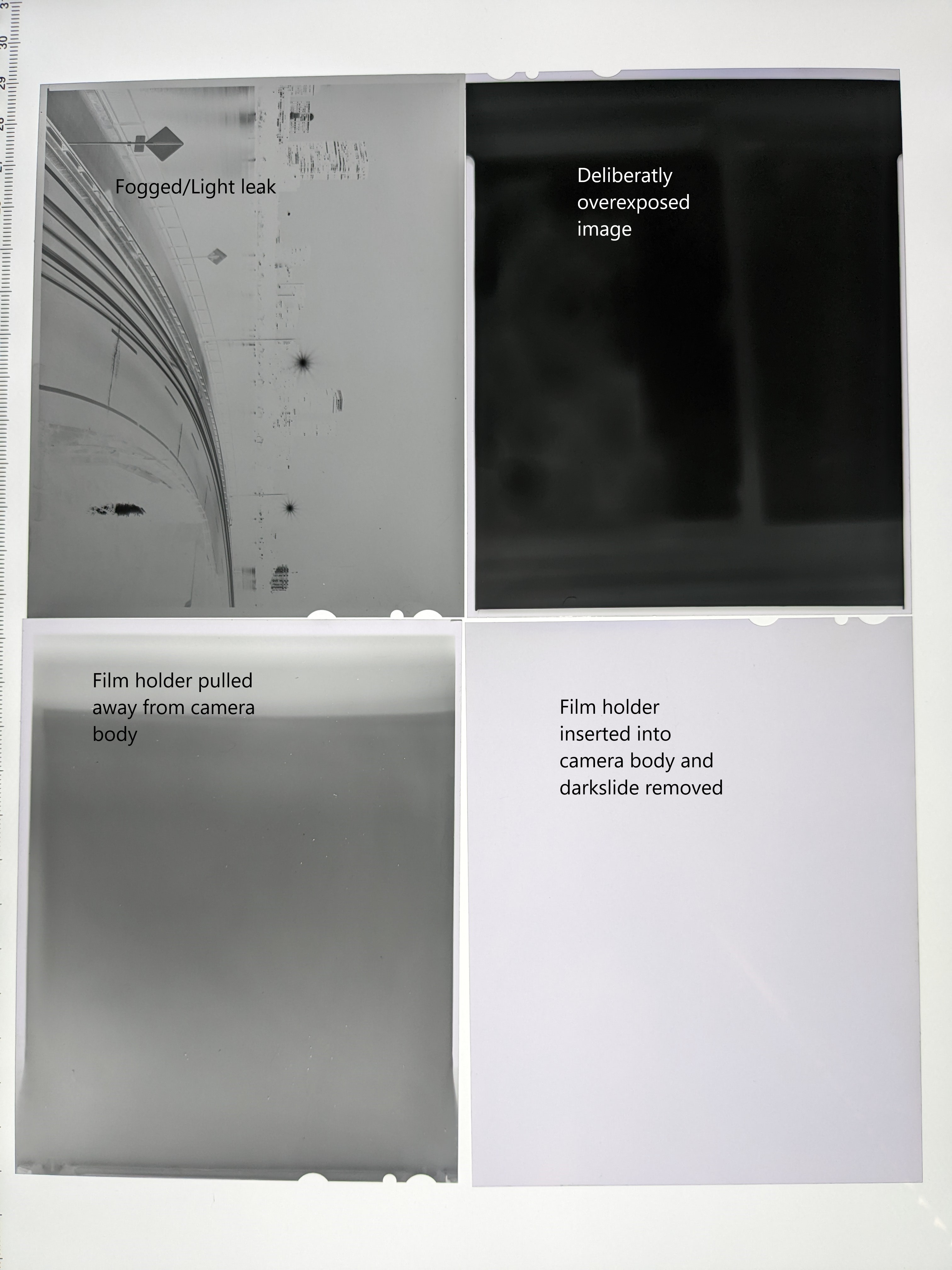

Please help me figure out this light leak. I'm loosing my mind!
203,112
2,849,939
101,671
MiriTHEJake
cirwin2010
Jan 3, 2021
281
Massachussetts
Analog
I made a similar thread a few months back, but I'm making a new one since I have done some testing.
Problem: Most of my hp5 4x5 negatives are fogged. The side of the film with the notch codes will be darker than the other side and it forms a bit of a gradient. The fog is present in the film rebate area which is where it is most obvious. I will occasionally get a "clean" negative, but I cannot pinpoint the cause of the problem. I originally thought it was an issue with my sp-445 developing tank, but switching to a Paterson tank has not resolved the problem. See first attached image.
Equipment:
-New Chamonix 45F-2 camera
-New Toyo film holders and older Riteway & Lisco Regal holders
What I have tried to reproduce the issue (see second image):
1. Developed a negative from my box of new film to see if the box got fogged. Negative came out completely clear
2. Put a film holder into the camera, removed the dark slide, and shined a bright light on the camera to check for light leaks. Negative came out completely clear.
3. Put a film holder into the camera, removed the dark slide, and pulled the film holder slightly away from the body. This was an attempt to compare this type of light leak to what I have been getting. Negative rebates came out completely clear unlike the "bad" images.
4. Over exposed an image in camera to test if the issue is light piping or internal reflections from long exposures. Negative rebates came out completely clear.
NOTE: all above tests took place with Toyo film holders since these are what I normally use.
The above tests would lead me to believe that "bad negatives" I have been getting were a fluke. However, I went and shot more hp5 after and got more of the same results. I also exposed some fp4 in some Riteway film holders. The film rebates on those are completely clear. I am uncertain if the problem with my other negatives simply did not occur for those images or if the film is not sensitive enough to show the problem.
This problem is really dragging me down. I want to use my new 4x5 camera for my serious projects, but I cannot with these unreliable results. Please help me.

I'm wondering if the sheets have somehow been fogged in the film box itself.
Do you use the three part box as properly intended along with the inner lightproof bag ?

I would have thought the same thing. But my testing would have ruled out fogged film in the box. This issue has also survived two whole boxes of HP5 and now starting on a third. My test of developing a sheet straight from the already opened box came out clear, along with some of those other tests. I am using the three part box + bag.
Some Toyo holders had trouble with the dark slides not being completely opaque. See my reply to your question over on the LF forum.
Doremus
If the film is fresh then the problem will be coming from light leaking in around the dark slide or not blocked from entering when the dark slide has been removed. That would explain the variation in the fogging. Buy some new film holders and see if the problem goes away.
Fogging in the rebates when testing shows clear rebates suggest there's something happening with film that stays in the film holder longer. Chemical fogging and radiation could do this (though almost all radiation sources in a typical home are primary alpha emitters, and alpha is ridiculously easy to shield against). Try putting a fresh sheet in a film holder, and leaving it on the darkroom counter for a while, with another sheet kept in your camera bag for a few days? Keep track of which is which, of course.
How do you bring film and developer together? I see overly dense film edges with all samples. How do you develop?

The fact that it extends into the rebate area suggests it's either happening outside the camera, or there's a leak in the film holder itself.
I'd test the darkslide (unlikely, but possible) for transparency, and try flipping the holder open and shine a light through the flexible "hinge" of the film holder.

If you have a good bright flashlight pull a darkslide out and cover the end of the lit flashlight with it in a dark room. You shouldnt see any glow through the plastic.

Ah but the rebates would be clear if darkslide wasn’t opaque
My best guess is that the fog comes in handling. You may not have a completely dark darkroom or a glowing LED bulb when you take the film from the box and load in the holder, or out of the holder into the tank.
Ah you mentioned a changing bag. Make sure the elastic is snug and that you are in a pretty dim location to begin with
