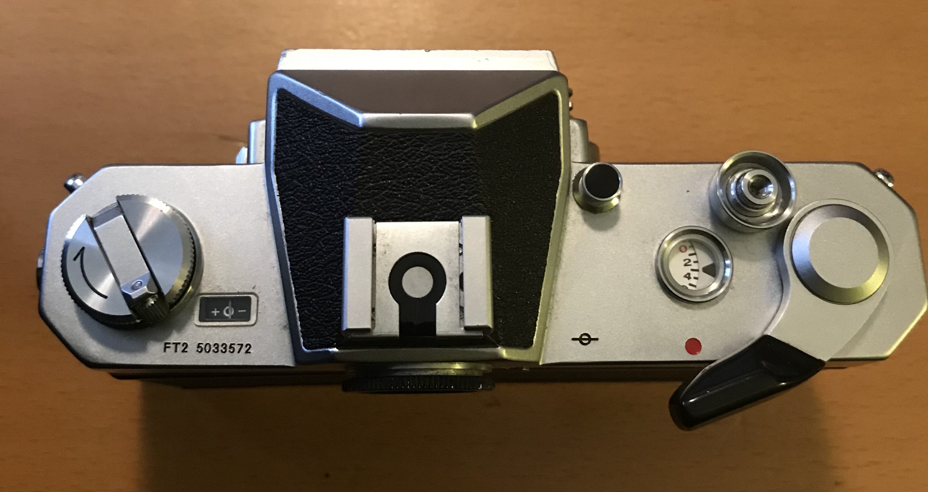

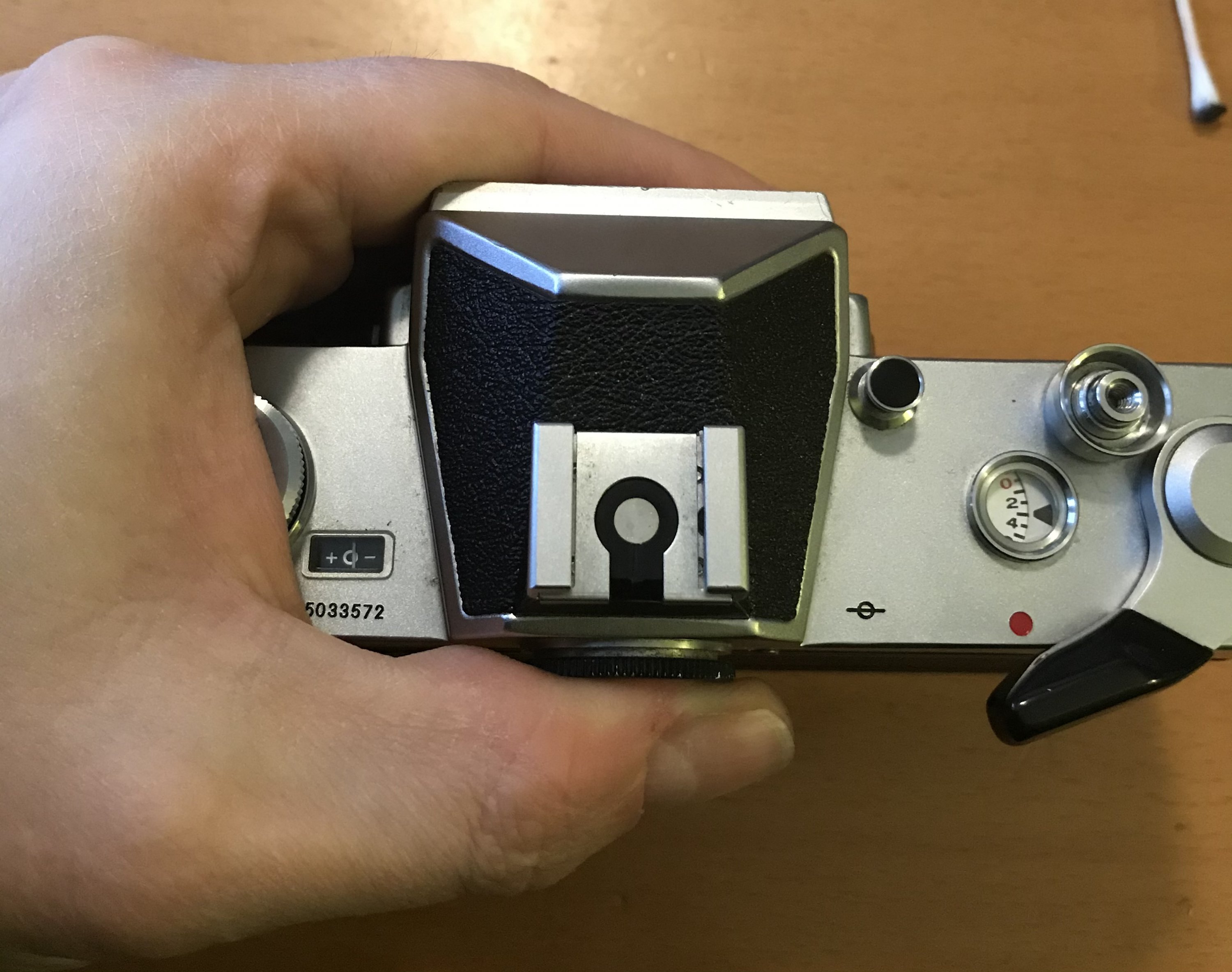

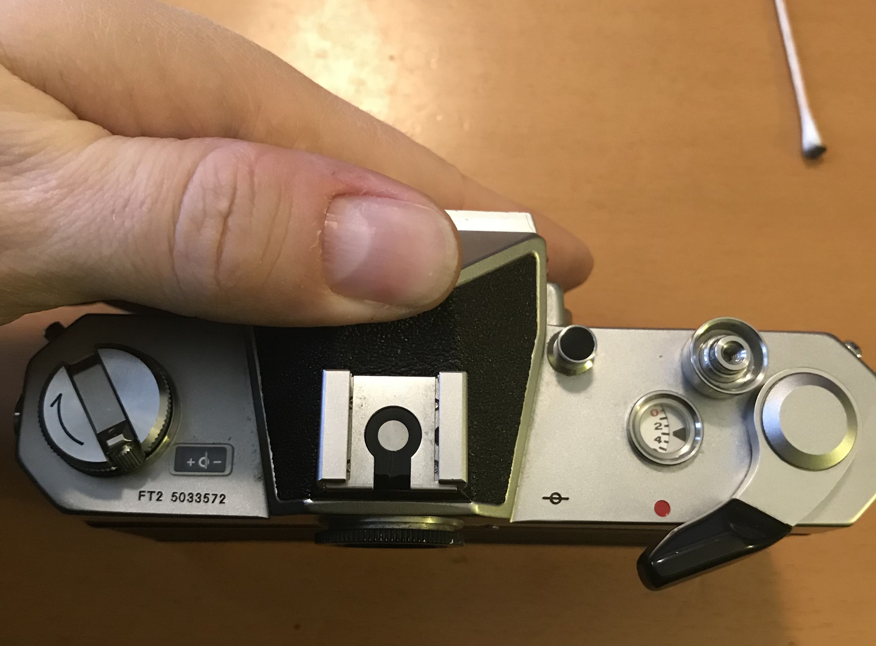

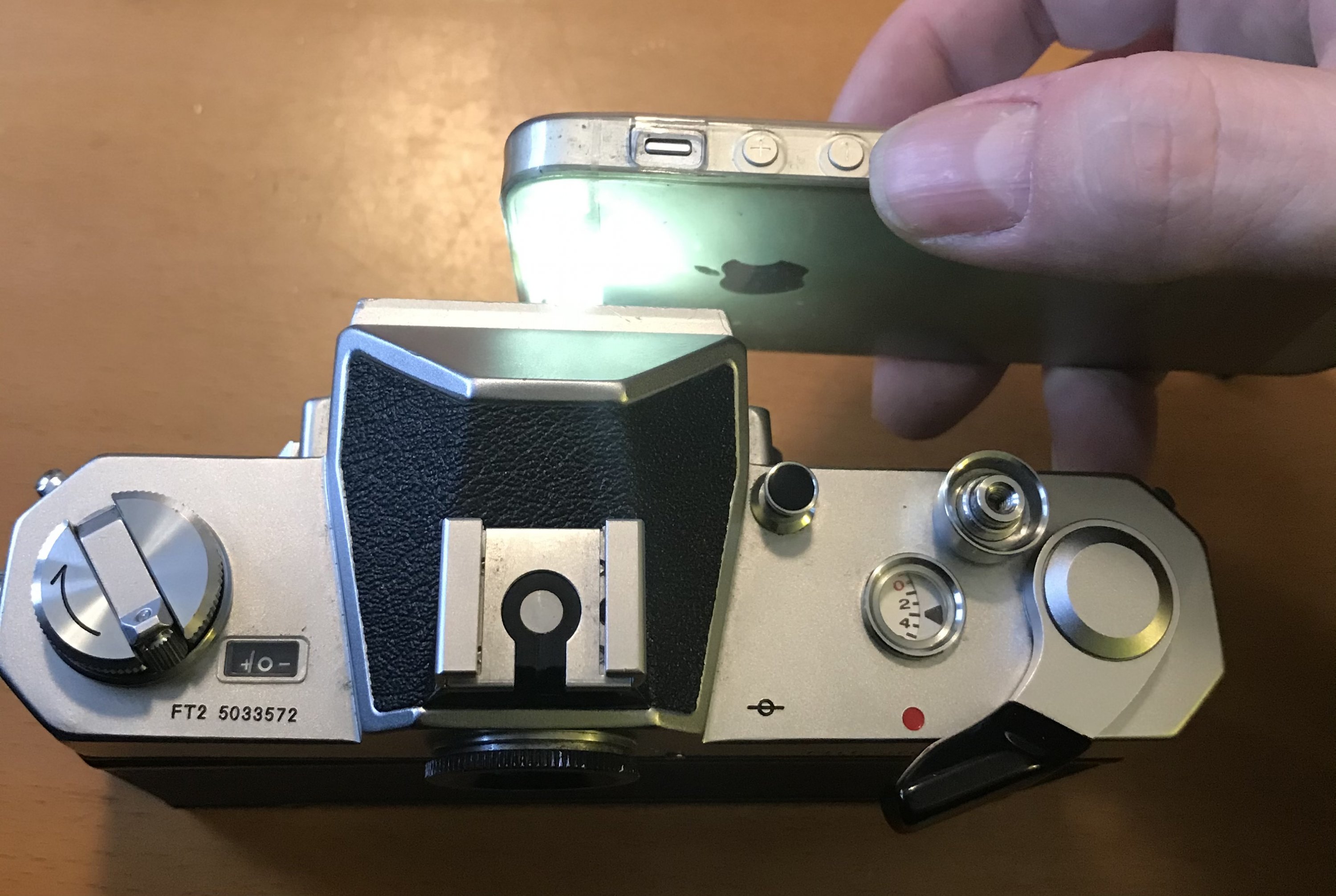

Hi guys,
I need some help, because I didn’t find a solution yet...
So, the problem is the lightmeter of my FT2, it doesn’t react to any change of light.
To show you the problem, I added some pictures. First I centered the needle to get the actual light situation. If I take away the light with my hand, nothing happens... if I light into the camera with a strong lightsource, the needle reacts a little bit to the plus-side.
So, what could this be? Where could be the problem? Are the CdS-cells tired? Or the resistor in the lens coupling dead? I cleaned that out, without any change in the situation. Does anybody of you know a fix?
Any help is highly appreciated!
Thx in advance.
