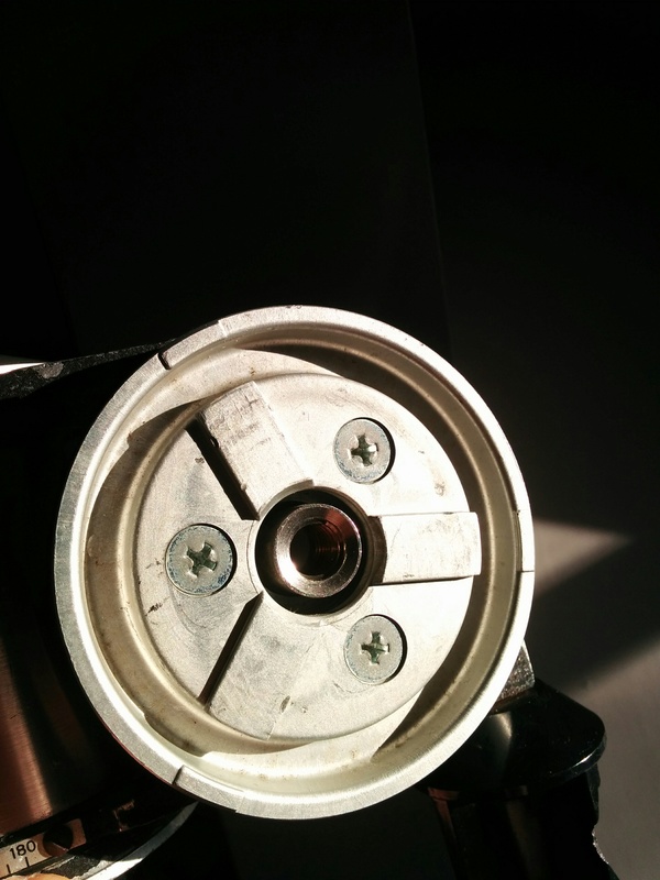

I've just received my Sinar Pan/tilt head. The base has a diameter of 75mm (around 3"). But on this base there is a smaller piece of diameter 55mm (around 2") receiving the screw to be fixed on the tripod (see picture)
I've tried the Sinar head on a Manfrotto 055. The smaller diameter fits on the tripod plate, but the remains part of the base goes beyond the tripod plate.
Do you know if that can be an issue to use a tripod with a smaller plate (and it seems 55mm or 60mm is a kind of standard), do I must need a plate of diameter at least 75mm to install the Sinar head?
Thanks.
I don't think you'll have any problems with a mounting base being of a larger diameter. The base has plenty of bearing surface and will sit very securely on the Manfrotto base. There should be three studs in the Manfrotto plate; align them with the triangular bases, and you should be able to snug everything down nicely. My only concern would be that the "arms" in the tripod head base won't align exactly to provide bearing surface for the studs after screwing to the 3/8" stud.
