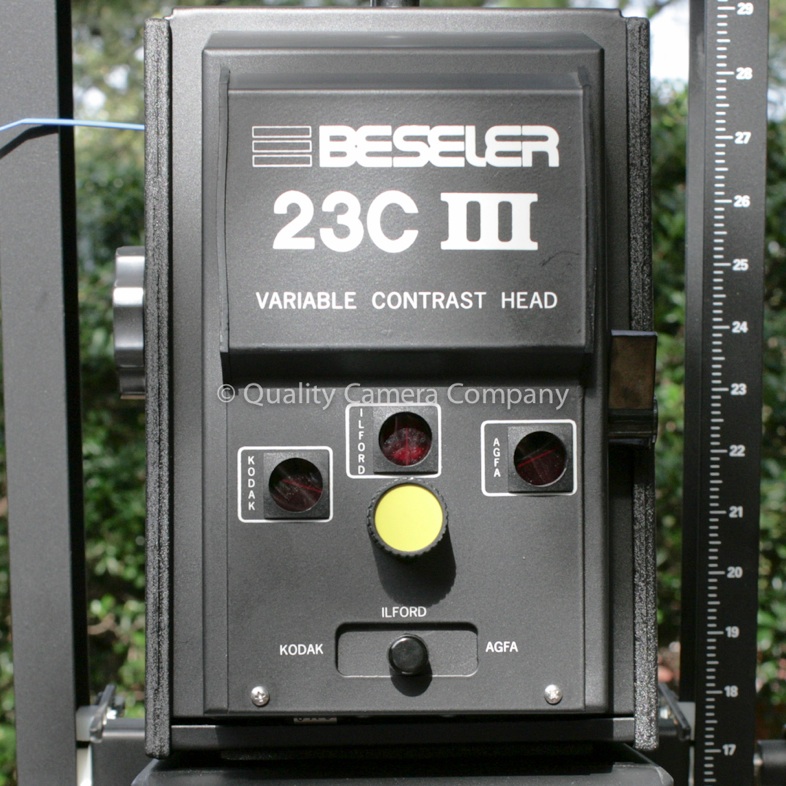

I know this is a really basic and almost stupid question. Can anyone help explain multigrade, specifically Ilford filters to me?
I'm printing on a Beseler 23CIII-XL enlarger with a variable contrast head. This is a link to the head. I'm printing with Ilford MG IV RC Pearl paper at the moment, although I do have some MG Fibre as well. My head has settings for Agfa, Ilford and Kodak papers if IIRC. The Ilford setting goes from green (0) to a dark blue/violet (5). The only instructions I found on Ilfords site say to just set it at 2 and go from there. One of the data sheets also explained that the emulsion on MG paper is sensitive to certain spectrums of light, hence why green vs blue light will help vary the contrast. They offer no other explanation on exactly how or in what situations you would need to use the different filter colors.

Whoops! Sorry to muddy the waters, but ghostcount doesn't yet have a good grasp about MG filters.
The best way to learn about them is to pick a negative, one you've printed before maybe, and print at each grade. Skip the 1/2 grades, if you want. The higher grades (4, 5) will need more time than the lower ones. The you'll have a good grasp of what the different contrasts are, and how they can be used for your printing.

Just in case this is where the confusion arises...
The OP appears (from his comments) to have a light source that approaches variable contrast in a relatively rare way - it emits light in varying amounts of green and blue, and adjustments are done by adding different amounts of green and blue.
Most of the information around, including information concerning the sets of filters, deals with light sources that are relatively full spectrum, and filters that subtract differing amounts of green and blue light.
It is important for the OP to think of light as a mixture of red light, green light and blue light. The red light is visible to us, but doesn't affect the paper. If the mixture of the rest of the light has more blue light than green, the print will be higher in contrast. If the mixture of the rest of the light has more green light than blue, the print will be lower in contrast. So what we need to do is adjust the contrast by adjusting the ratio of blue to green in the light.
So when he/she reads about using yellow filters, he is reading about taking light which includes lots of red, green and blue and subtracting a portion of blue (to increase the relative amount of green, and therefore reduce contrast).
And when he/she reads about using magenta filters, he is reading about taking light which includes lots of red, green and blue and subtracting a portion of green (to increase the relative amount of blue, and therefore increase contrast).
The OP's variable contrast head works more directly.

MattKing is correct. Here is a picture of my head
You can't see it in the picture, but you slide the bottom slider to the correct paper, then you dial the yellow knob left or right to select the number. The selection is a smooth transition, not a click to each varying filter. The numbers go from 0, .5, 1, 2, 3, 4, 5. In theory, I could choose something between the numbers to have a slightly different mix of blue/green than directly on 5. There is also a lever on the side to enable unfiltered white light to come through.
Thanks for all the wonderful detailed responses. I guess I was lacking a bit of understanding on exactly what the contrast numbers meant in the first place (regardless of what color the light is). I've never spent much time in the darkroom and don't even have experience with graded papers. I work in the graphic arts industry, so I have a good grasp on additive vs subtractive color theory. I suppose the Ilford manual spends more time explaining that since its much harder to wrap your head around. My head is actually much more intuitive. low number = low contrast, high numer = high contrast : )
