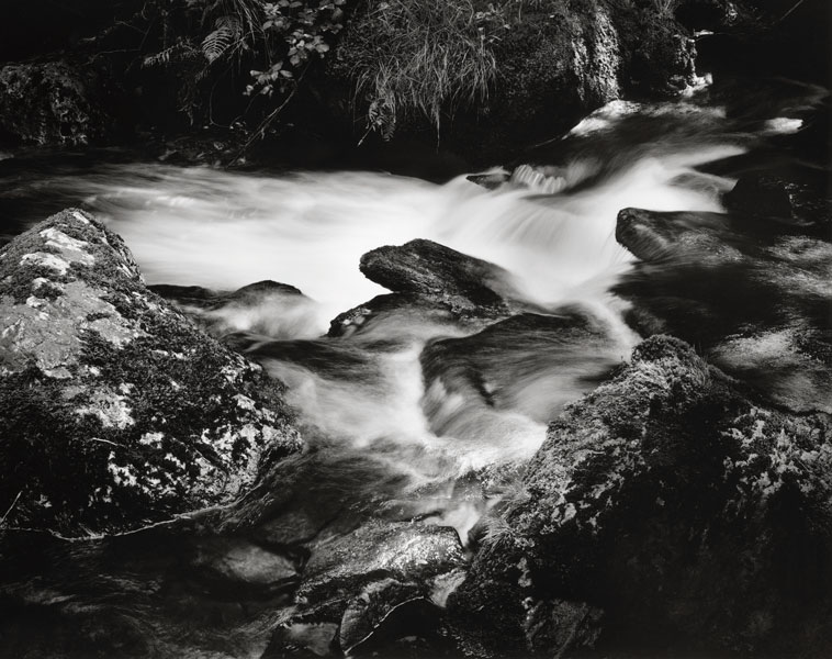

i've already dealt with that temptation, i would LOVE to use xp2 but i think my wife and sister in law are wanting a more traditional look :sad:
What are you talking about? It doesn't look any different just is virtually grainless. Is this traditional enough for you? Shot on XP2 and enlarged on fiber-base paper, then toned.

i'm talking about the high level of contrast. i love it, but i think they're looking for a softer look, meaning more grays and less striking black and whites. my understanding is that xp2 is somewhere in between "normal" film and infrared. the "normal" look is really what i think i'm aiming at for this specific instance.
but, i'm going camping in Shenandoah national park in a few months and plan on photographing lots of water and i think i'll take along some xp2 on that trip, your result is really pleasing to my eye.

i stand generally corrected... i was confusing xp2 and sfx. now i'm back to square one. is the high contrast due to your development or the film?
Ilford XP2 is ideal for high-contrast scenes. It has an exposure latitude beyond belief. This image was taking in Wales. Direct sun was hitting the white water and the shores were in deep the deep shadow of the forrest. I took the same image with Tmax, which was totally hopeless. The XP2 printed with ease. In the end, I liked a bit more contrast in the image, so, I printed it down in the shadow are, but all the detail is in the negative without the highlights blocking up.
I believe this film may be ideal for your wedding. You will have to deal with dim ambient lighting, but have bright sunlit windows in the frame as well.
By the way, XP2 is useless for low-contrast scenes. You end up using grade-5 paper and it's still too soft. but in high-contrast situations, there is nothing better.
