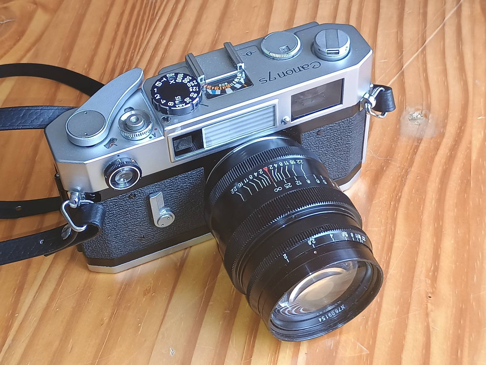

Here's a search on Flickr of the Jupiter-3 50mm f/1.5. It's a Sonnar design.
The Jupiter-8 is a less expensive slower alternative at f/2 which is also very good.

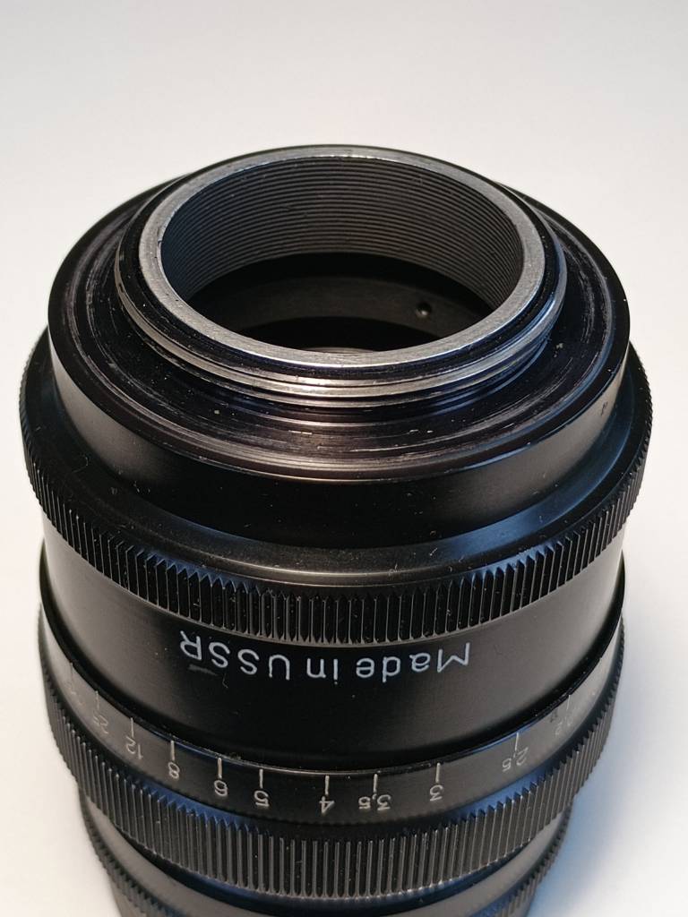

I've used the Volna-3 lens you mention for a long time and love it. Lately I've been using it on a Mamiya 645 with an adapter that is widely available.
To get similar results on 35mm, you'll want an old very fast 50mm, made in Russia or Germany, most likely, using it with slow or medium speed film. Because the 80mm is a normal focal length lens on 6x6. And because f/2.8 is equivalent to something like f/1.4-1.8 with the change in formats. The Soviet lenses were mostly inspired or copied from pre-war German designs.
I think all of the Soviet Jupiter-3 lenses were coated. Possibly a limited number of the earliest post-war units with original Zeiss glass may have some uncoated elements. Sonnar Brian is the expert on these lenses. Regardless, if you want the flarey uncoated look, the Jupiters won't quite provide that.
The other big issue is finding a reliable Jupiter-3, not a fake that has been hacked together from various lenses. A good one is no longer cheap, as per 10 years ago.

Well, the Volna the OP originally posted was also likely to have been coated. Mine is marked MC. They were made into the 90s. Even with coatings, these lenses are lower contrast unless stopped down twice. They also have a flaw in how their stop-down lever is designed that can let light into the optics through the side when it's used in the closer half of its focus range.
