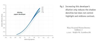

My measurements with Dektol show a more significant loss in Dmax. See attached.

What Ralph shows is a typical exhaustion problem in areas with lots of silver development. This is essentially developer exhaustion expressed in sensitometric curves..

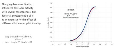

Yes, within reason. See attached.
I see and that's about what I'd expect to see. I've known, and seen the warming trend that presents itself with some papers when using more dilute developers, and have commented on that in several posts in these fora. I notice it most with Arista.EDU Ultra papers (Foma something) sourced from Freestyle.

Well, notwithstanding what Ralph has posted, which is all correct, don't forget that the capacity and keeping of the dilute developer is much lower as I noted earlier here. I'm sure that Ralph used fresh developer for his tests.

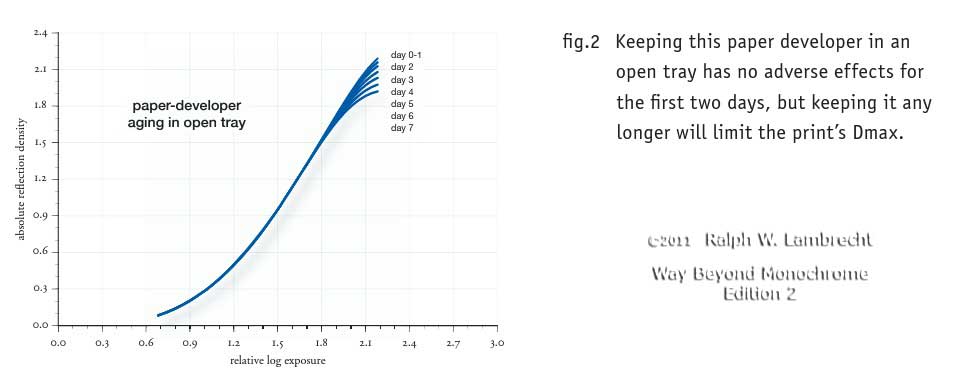

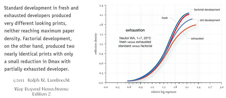

PE is correct. I used fresh developer for these tests (even that I question that practice sometimes). In addition, I conducted two more tests, one for developer aging (still fresh developer) and one to compare the difference between fresh and exhausted developer, and how much factorial development can compensate for it.

Again, Ralph has shown an important set of data! Don't ignore it.
The first figure could represent an evenings work instead of several days keeping. The dilute developer might give you that series over a set of a dozen prints or so. The right figure might represent extremes in keeping as well as the actual data it shows. Dilution or over dilution can present the DR enthusiast with a real gotcha!
