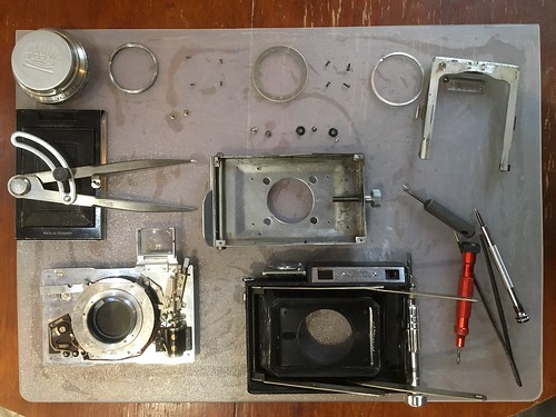

Hi all,
A friend from this forum got his Makina III fallen and the scissors are bended, I took the camera for restoration/fix and decide which Makina I prefer (black or silver).
Making III striped and tools used.
Here is the full pictorial how-to:
https://flic.kr/s/aHsmAby6oF
Now I'm waiting Anticomar 100/2.9 to adjust rangefinder and do some photo test.
Thank you for watching,
Alex

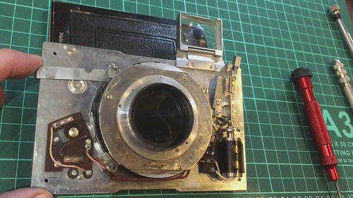

Could you explain the sync connector-socket? What is the use of the intermediate bore? It has no electrical function. Could it be intended as a mechanical fixture?
I do not know this connector from other appliances so it seems proprietary and not a standard 3-pole plug applied on a camera that only needs a 2-pole one.
By the way, parachutist seems not the right term. Freefaller would be more apt....
No, I haven't disassembled that part since the problem was not there, if it works don't fix it.
Uhm... I'm lost here, do you mean the big cylindric thing at the right? Maybe the answers follows below... If you mean other part let me know, I could be lost in translation.
I quote camera-wiki "In 1949, the Makina III replaced the Makina IIS, with the full flash synchro (electronic and magnesic), a shutter locking button, no self-timer and a holding plate with two tabs attached to the right side of the front plate, where in previous models the diaphragm selector was located."
Joke mode on // Indeed freefaller would fit better if I wanted to say the camera felt/jumped by itself but I can't imagine why any camera would do that to a certain "death" or future disfunction so I thought the camera had a plan not to hit the ground and that's why I guessed the parachute didn't work, about where you can wear a parachute in this camera, my guess is inside upper frame hiding, so opened and held by the upper scissors would make the camera waft softly and land in horizontal position. I could be wrong of course, airbags were not invented by 1952 so... // Joke mode off.
The camera was CLAd by Frank Marshman 3 years ago, I saw some very nice details, I haven't done anything than fixing scissors, shutter works great, focus and other operations are fine. The big job I did it in my Makina II months ago, the differences between these two are the flash socket and some screws here and there and of course Lens in front of shutter in Making III.
Yes, I meant that "brown connector thing" at the front, with its 3 bores, out if which only 2 are neeeded and thus wired.

I know of that adapter.
And as you got one you might explain how it is fixed in the old one, repectively why the old one has 3 bores.
The adapter has three pins, that are pushed into the camera front socket. Why three? I don't know that answer.
The answer should be here and in Makina III catalogs:
It seems the socket fits this flash-pole connector. Maybe it's related that same socket is used for two kind of flash (electronic and magnesic) or full synchronization.
A tip, when I had the front opened I played a bit and I remember something new for me, cocking the shutter already connected some wiring from the flash. Could it be they design a flash which was waiting the cocking to start charging? (I'm not expert on flash or how they work but I remember the one I had when I was kid hearing it charging).

The Makina III has 2 ways of flash syncronisation:
-) for bulb flashes by the solenoid (to be seen on your Flikkr photos), which acts as retarder. The solenoid, and thus the shutter, are released at the flash
-) for electronic flashes by X-synchronisation, triggered via the shutter by the camera release
Switching between the two synchronisations is to be done by switch at the front standard.

Hi,
Maybe this was already answered but...The dark looking cylinder is an electric magnet so you can fire the camera from a button on the flash. I believe.
