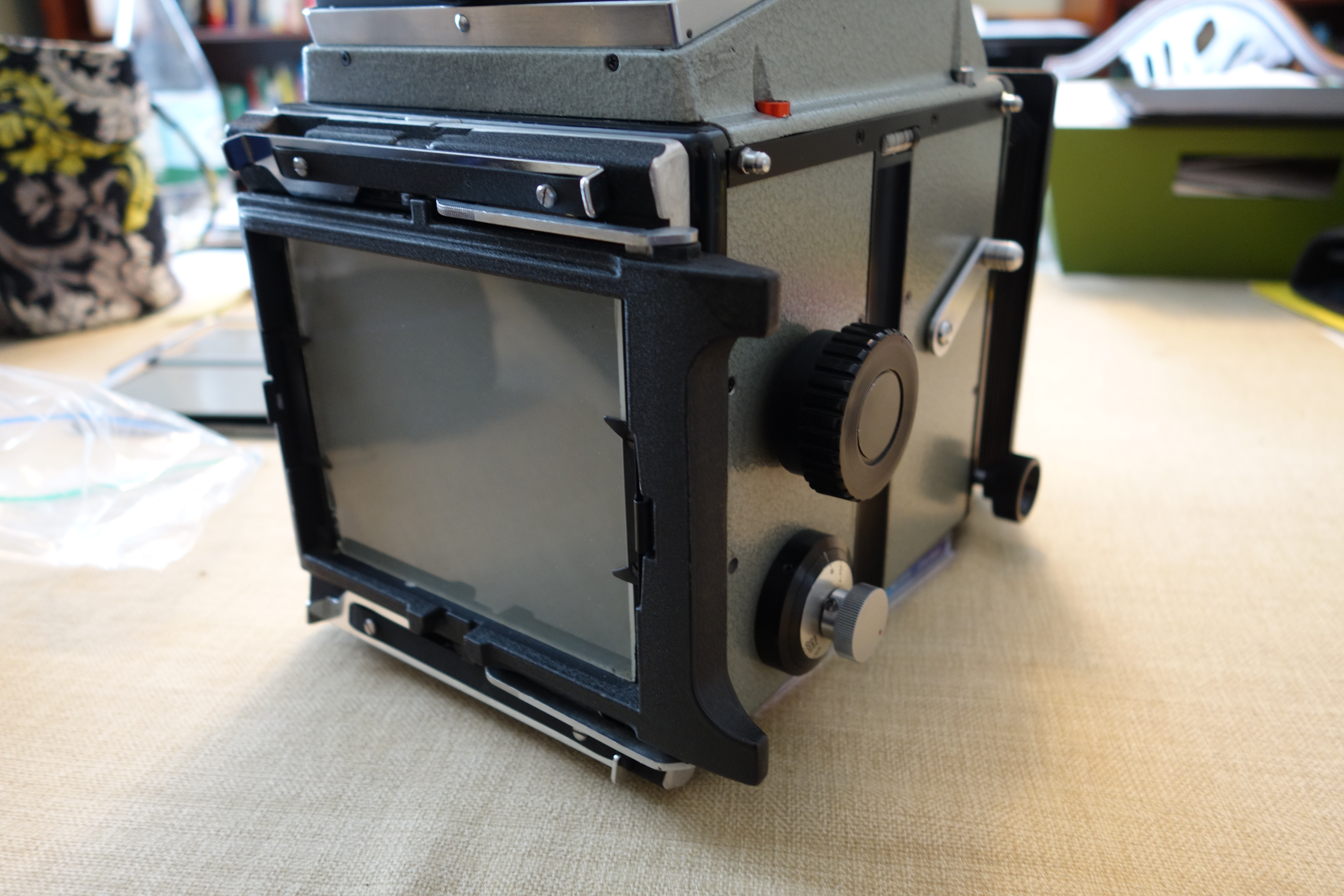

Here is my new freshly restored Makiflex Back. New light sealing inside, and the metal strip on the front was coming off. You can see the black velvet light trapping glued to the back side of it on the far right). I re-glued it back down, using contact cement. Now ready to use on my cameras.

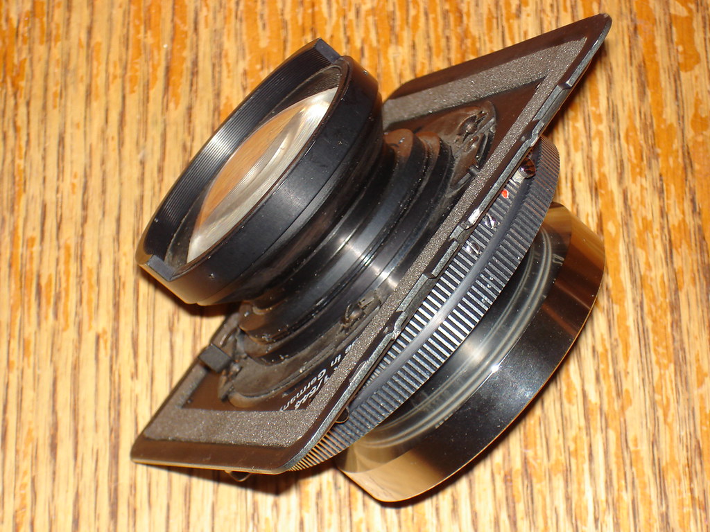

A fellow Apug member contacted me, and together we purchased Igor Reznik's Plaubel Makiflex 150mm F2.8 Xenotar in Plaubel automatic shutter. The other fellow wants the front and back cells (the rear has hundred of micro-fine scratches) and I want the Plaubel Automatic Iris Mechanism. I also have a 150mm Xenotar, in a regular barrel mount. So we will both benefit from this deal. Here is the Xenotar on one of my Makiflexes, Igor loaned it to me for the weekend, a year or two ago:

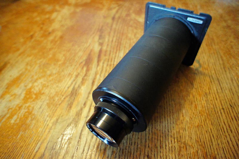

As a final step I am lining the interior of the lens tubes (from China) with laboratory flocking paper. The tubes do have an interior sheen so better to flock the interior of the tubes. This one is the dedicated tube for the 360mm F11 Kern Apo-Repro process lens.
The completely finished Kern Apo-Repro 360mm F11. Quite a rare lens. Fabulously sharp and contrasty.
Easy to focus on the Makiflexes, even though F11. This is surprising. It's actually very light in weight and balances well on the cameras.

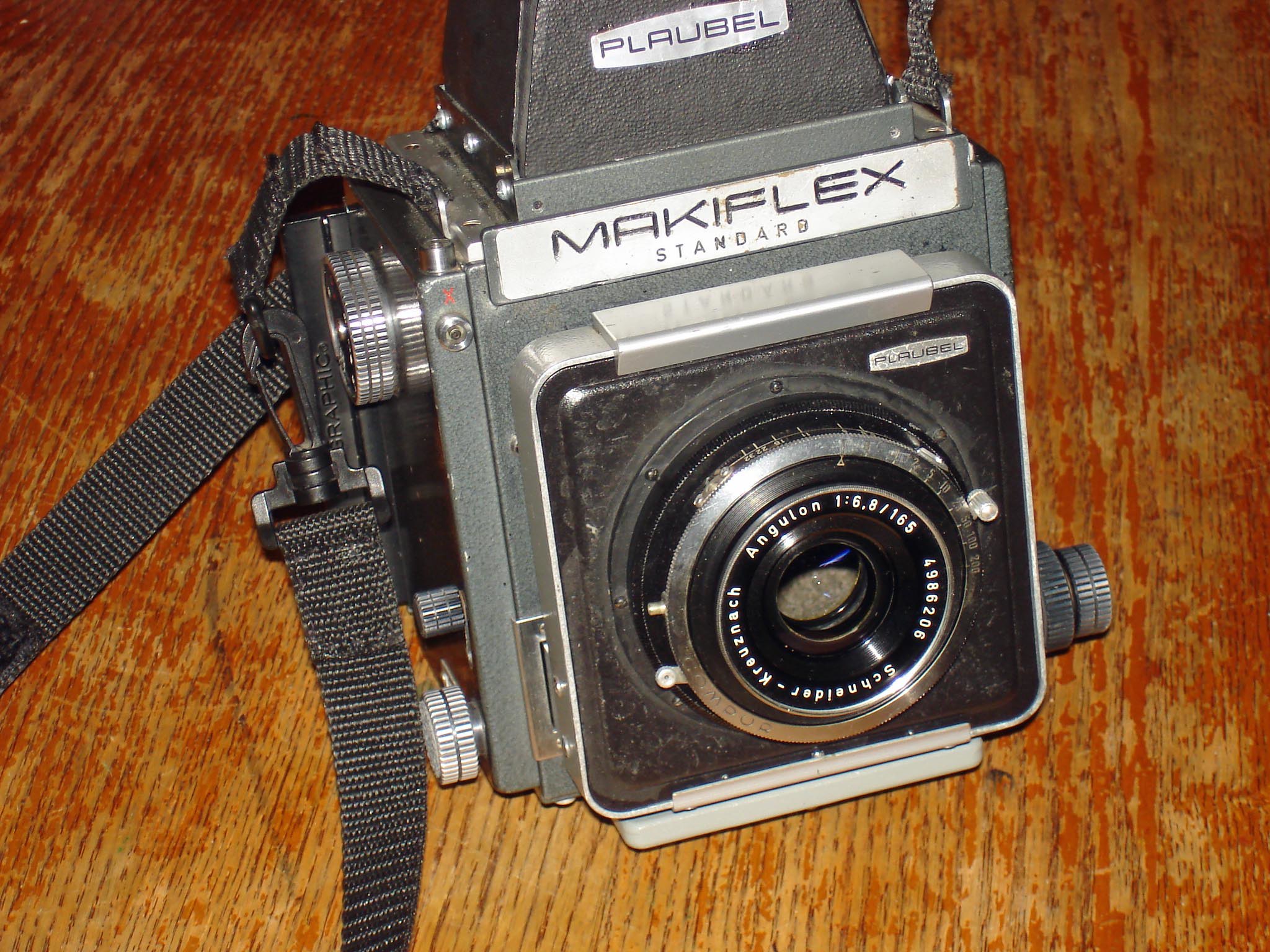

I enjoy the 120 Angulon on the Makiflexes. Today I mounted my 165 Angulon onto a Plaubel board (Man it was HOT in the workshop), previously I've been using this lens on my Sinar Normas. Glad to have both of the Angulons for these cameras. Here it is focused at infinity.

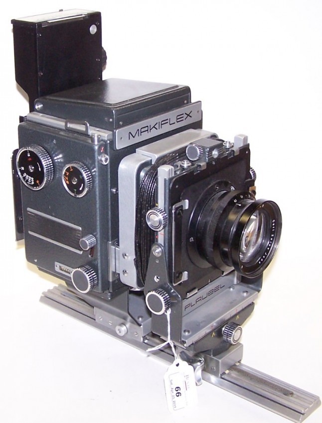

After many years, Igor Reznik up in Cleveland is selling off his Makiflex stuff. Earlier this year I got his Plaubel Makiflex Auto-Iris for the 150mm F2.8 Schneider Xenotar (a rare piece for sure). Anyway I talked to him this morning, everything is gone, except the Makiflex Attachment With Bellows PX1/08. This converts the Makiflex Standard, or Automatic Makiflex, into the Pecoflex. Previously he could not find the focusing rail for this unit, so frankly, I wasn't really interested. But now, he found all the pieces, and I just bought the complete unit. Will post some pictures when I get it.
Since I have three Makiflexes, this will be a very useful accessory to have for this system :smile:

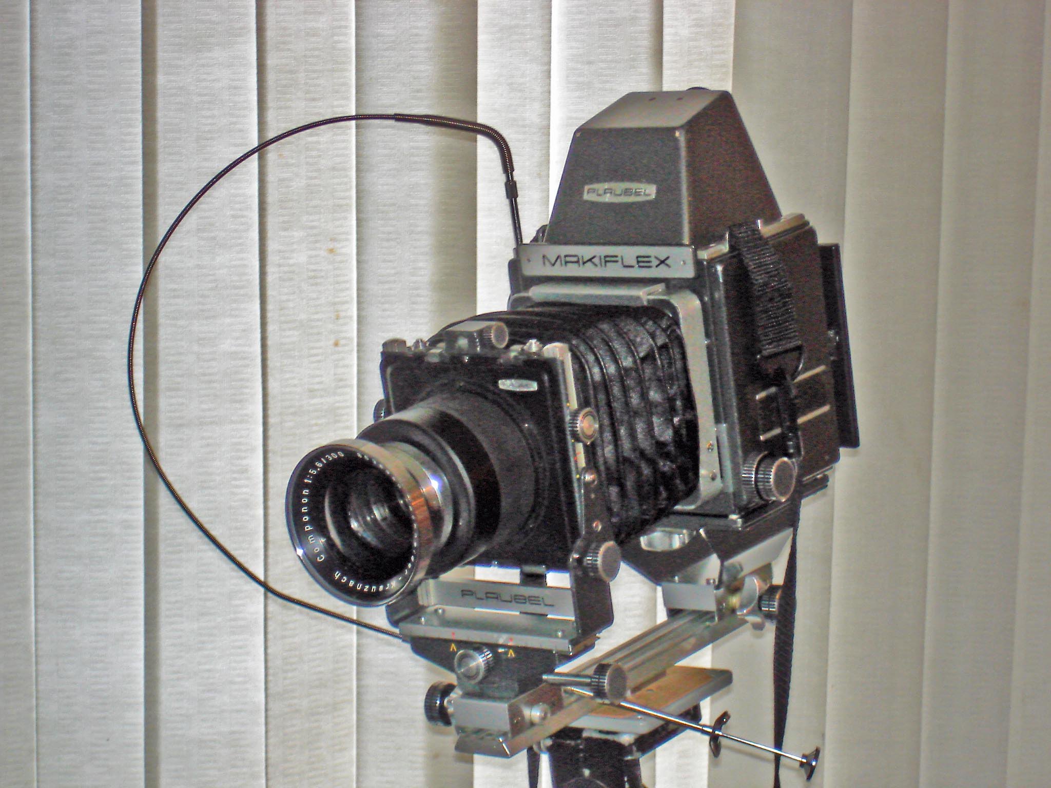

Just arrived! Maki Bellows Attachment for Makiflex. Turns Makiflex into Pecoflex. Shown here with 300mm Schneider Componon, camera focused at about 3-4 meters. Lovely on the groundglass and an extremely tight closeup with the 300mm. Useful to have front swings, tilt, and lateral displacement. I would say as precise to use as my Sinar Normas. Love it!
It is even more than a standard bellows attachmend as it yields front standard movements.

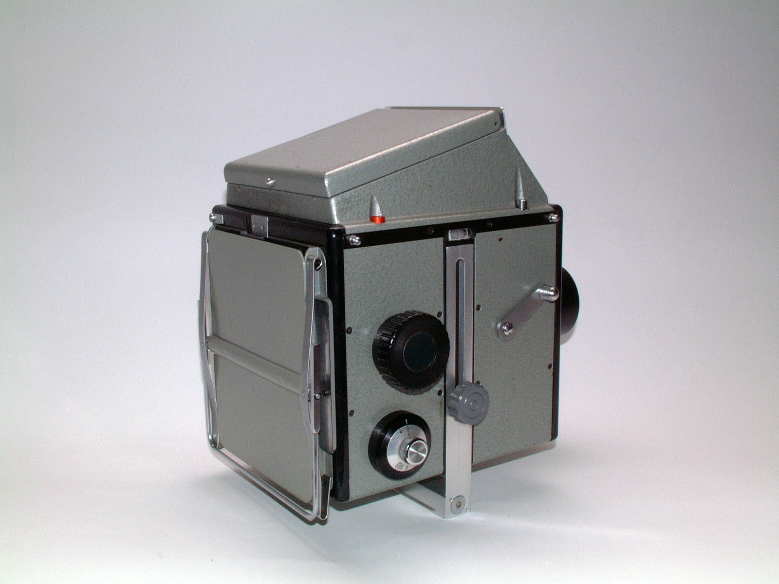

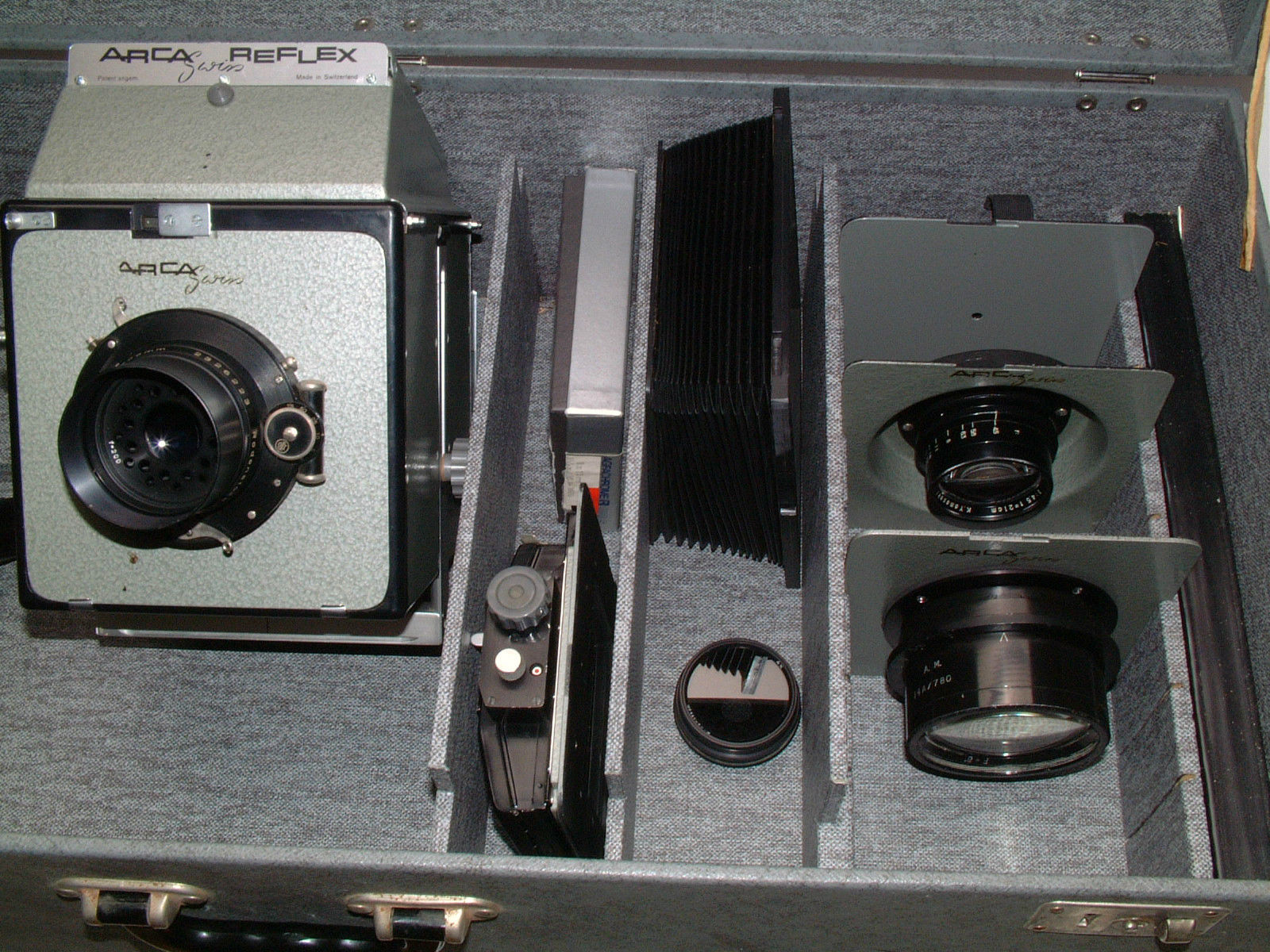

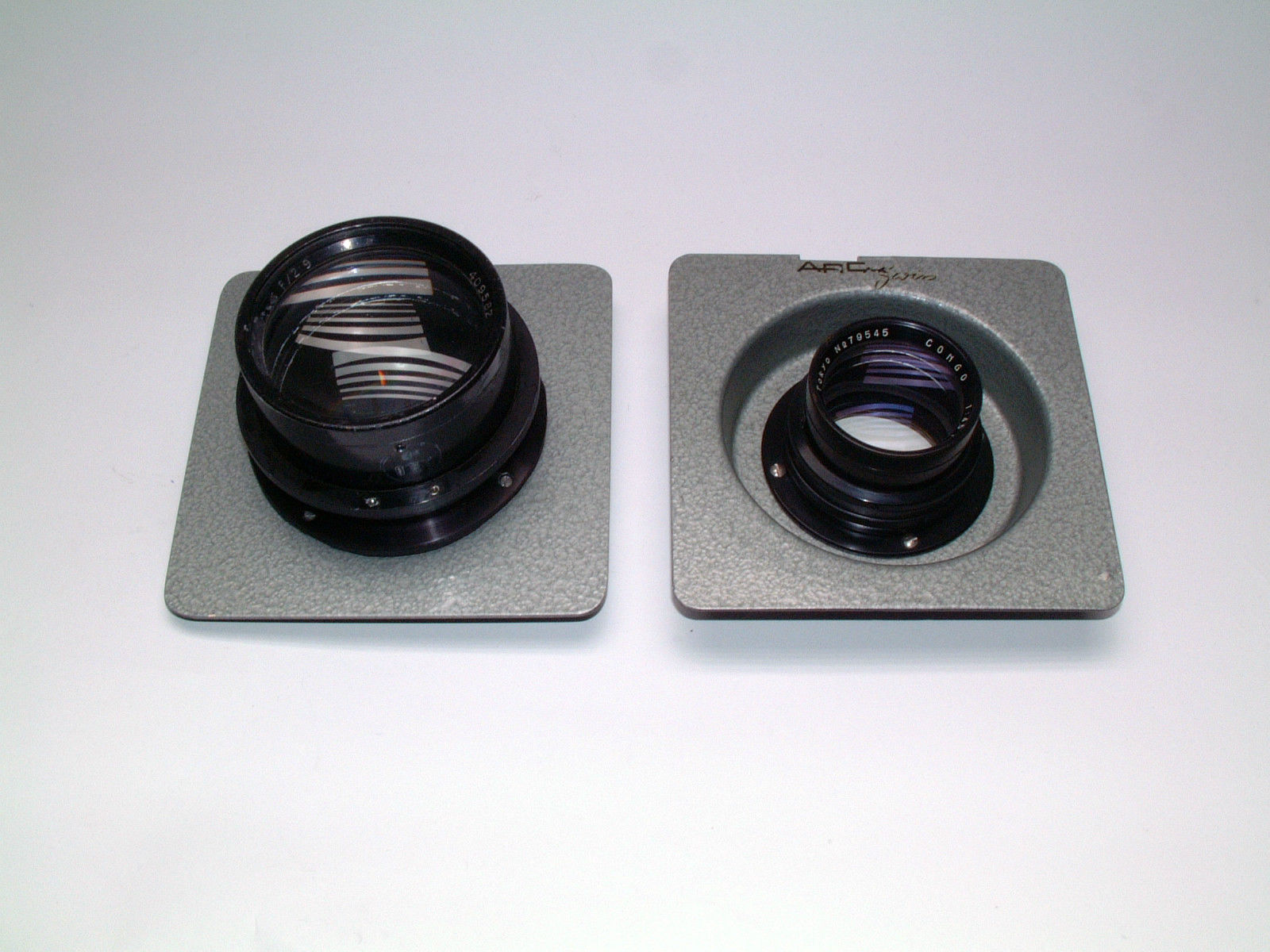

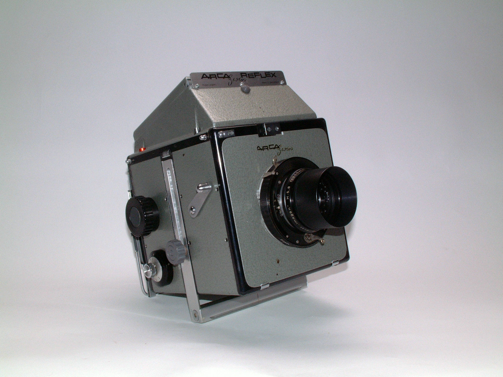

At Dan's request here's some pictures of my Arca Reflex 4x5. I was the other half of the buyer for the Igor 150/2.8 Xenotar (I needed the cells), with Dan. I used the cells for my Cambo TWR (also pictured).
For the Arca I've made a few spare bits, including a few lensboards (one of which is a recessed one), and also adapted a Graflex Graflok back to the Arca so I can use Fuji FP100C45 and other Graflok film holders more easily. (they will fit in the stock arca spring back but it's a stretch).
The Arca required a little refurbishment, mostly renewing light seals and some CLA on the shutter. It works great now! I have more pics I'll post somewhere of the insides, if anyone is interested. It uses a double-blind curtain (fabric), self-capping, adjustable from T, B, 1/10 or so all the way to 1/500. Fully mechanical.
It's an interesting alternative to the Plaubel reflex cameras, can't quite take as short a lens (180-200mm or so is about minimum and still get infinity) but overall I enjoy it a lot.
