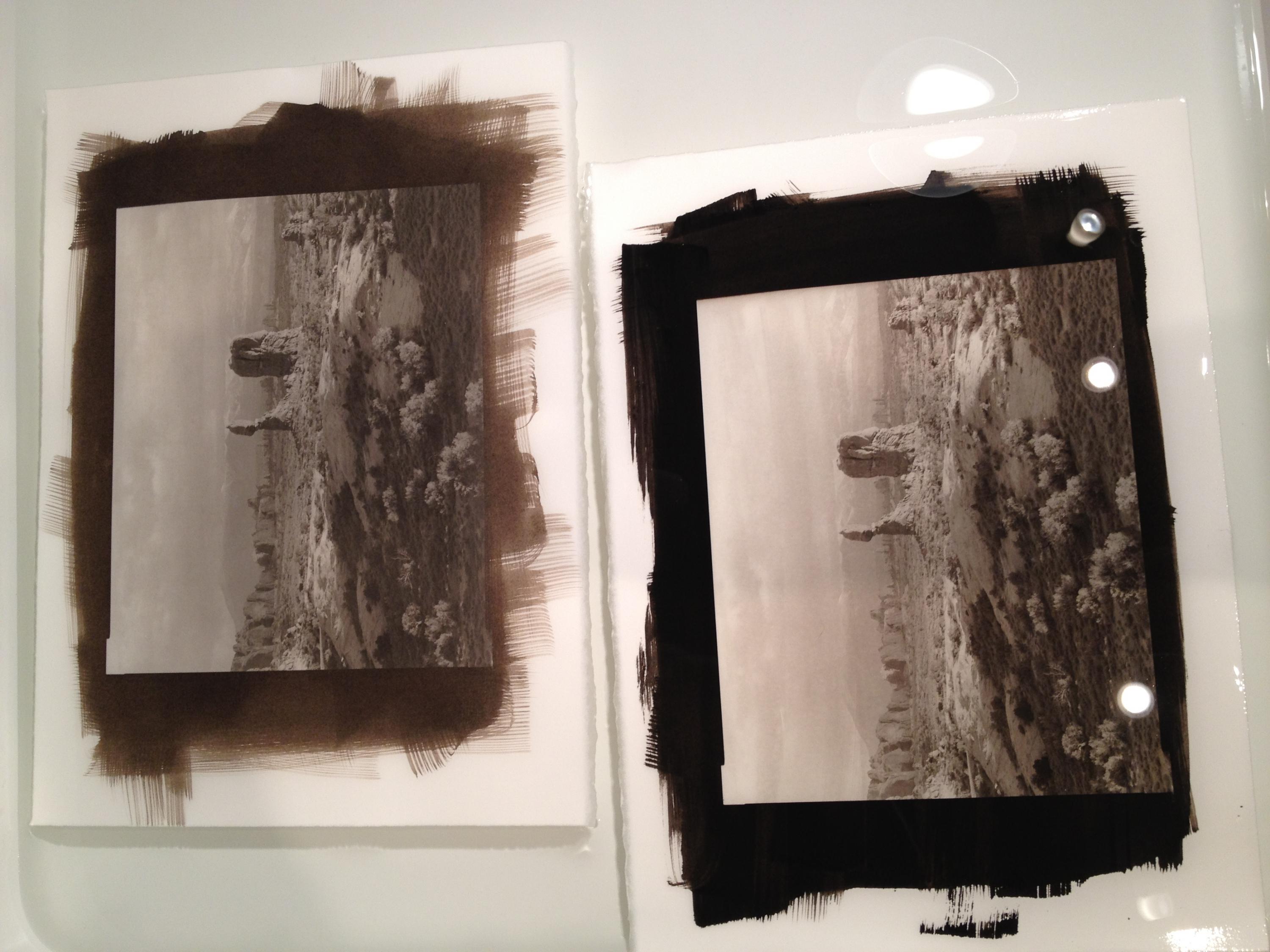

I read on Dick Sullivan's blog the other day about the use of Fumed Silica and gave it a try. I have posted a short essay on Facebook about this easy process.
I thought the results were worth sharing. I made the portfolio public so I think we can all see it even if we're not friended.
http://www.facebook.com/media/set/?set=a.3157306927923.2148017.1122723189&type=1
Feel free to comment.
Apologies to those who can't see the essay, here is a comparison of the difference.
Image on the left, normal development process, image on the right, the use of fumed silica applied to paper before coating with metals.

Yes, we've been playing with Fumed silica with other processes as well. It looks promising for many alt processes, including cyanotypes, kallitypes, albumen, etc. We're now just experimenting with another fumed coating (not sure if I am of privileged to discuss it here) that looks to have the same benefits of fumed silica with PT/PD printing, except with a slightly cooler tone rather than warmer which appears to occur with the silica.

I was worried about getting an even coating with a roller. I'm not a fan. But a brush has worked quite well for me.
After reading the pdf, it seems people are really over complicating it.
I found that I needed no more exposure and no more emulsion than normal.
It did take me a couple prints to get the emulsion smooth with my magic brush.
I used an expensive foam brush for the FS. Easy peasy.

Did you compare by doing a minimal exposure test? It seems from our experience that it needs to be brought back ever so slightly in exposure.
Also, I really think that dry application is easier. With a roller and an open space to spill onto, you could coat many sheets very quickly and evenly.
I can see where pulling back maybe a third of a stop would be advantageous, but I am quite happy with, at least for most exposures, just exposing the same amount. I really didn't lose much in the shadows at all.
Different darkroom, different humidity? Who knows. I don't want to over think it. I look at this as a lovely gift and my biggest concern is I want to avoid thinking I might have to go reprint 20+ years of pt prints :D
I really like what I have found with the brush. It's minimal, fast, non-messy. I think the wet might be more problematic. On the Platine, I can see easily if I have a smooth coat and good coverage.

We did the initial testing on Stonehenge--solid results--as well as Platine--not as solid...but not sure exactly why. Last Saturday we did a full run on Lana Aqua. and it responded quite well although I won't see the results until later this week.
Interesting method for rolling it on. At this point, we've been using foam rollers and it spreads quite easily. I see no advantage to wet application for my purposes yet, but different strokes for different folks. Dick was very happy it worked out for you so well, it's good affirmation of what we've been seeing.
