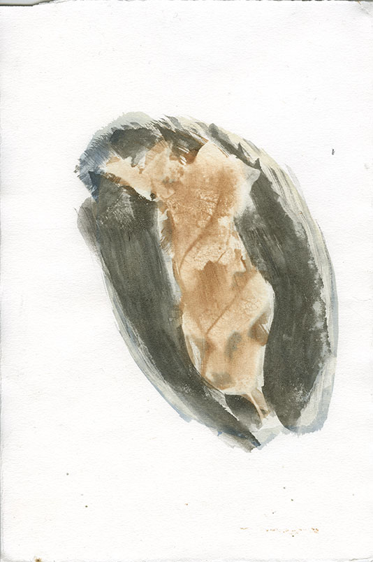

here's one that I did that was a gum print from a cheap cellphone snappy printed on cheap ink jet and then printed .. 2 layers over cyanotype ... not sure if you have your own light source but having a UV light bank cuts down on exposure times and a light bank can be made these days inexpensively, or an inexpensive silk screen uv unit, or early 20th century contact printer can be re-bulbed with a lizard warming bulbs &c from a pet store.
