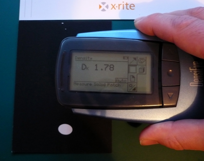

With all this talk about dmax I did a few tests yesturday and the highest reading I got was 1.78, Platinum/Palladium on Arches Platine non waxed (see attached). I put down a heavy single coat, humidity was 49%. Potassium Oxalate Developer (Dichromate as contrast contol)
Having checked my densitometer with a friends analogue one, my readings seem to be out for some reason and will have to send it off for recalibration. The more accurate readings from his meter were averaging 1.4 to 1.5 on Arches Platine non waxed.
