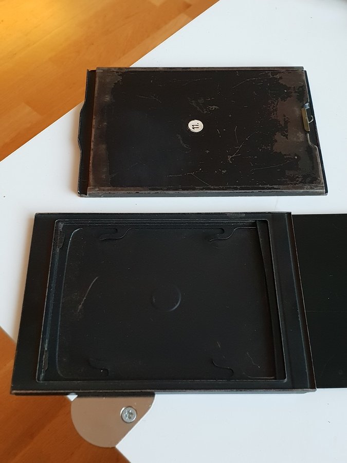

I'm new to large format. I'd like to start with an early camera, and I'm offered a Zeiss Ikon Ideal 250/7 (9x12).
2 holders comes with it. I don't think they are original, but the owner says they fit the camera all right (one is named ICA).
My question is: will the holder(s) take film? It seems to me that it is made for plates, and that something would have to be insered behind the film to hold it flat?
Those are definitely plate holders. You can shoot plates or get a 0.050” thick piece of glass cut to the proper size to use as backing for sheet film.
9x12 sheet film is slightly smaller than a 9x12 plate so needs fixing to glass or card or it can fall out, it's the same with all sheet film formats. Some claim use a drop of honey or similar, it's better to find some film inserts.

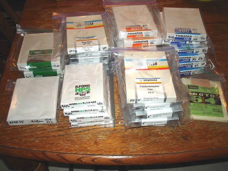

Ian,
I bought three unopened boxes of Kodak 9x12 sheaths on Ebay a few years ago. Quite a deal and I still have them.
001 by Nokton48, on Flickr
I have loaded my freezer with 9x12cm sheet film, among other sizes.
