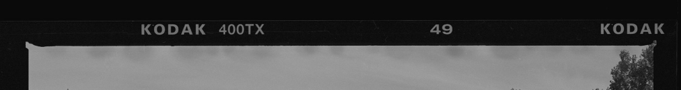

This is an image from one of the films developed with the Paterson reels, showing the air bells. This is the worst example I got, most of the films had a lot less marks.

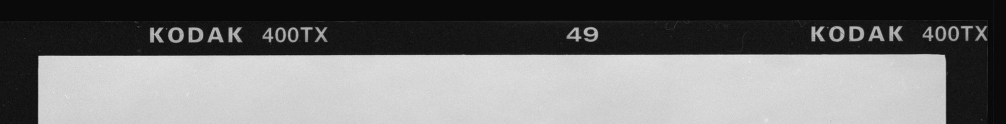

One of the rolls developed in stainless steel, the whole roll was just the clouds, and no airbells. Other test films (white wall indoor so even exposure of the whole frame) also show no marks.

Michael, I developed a roll of 120 TMax400 yesterday and got the same air bells that you show above. In my case:
1 minute pre-soak
Patterson plastic reels
500ml fluid
Ilfosol 3
10 sec agitation each minute
Quick pour and immediate initial agitation
I'm going to try a good scrub of the reels and also increase developer to 550ml and report back.
