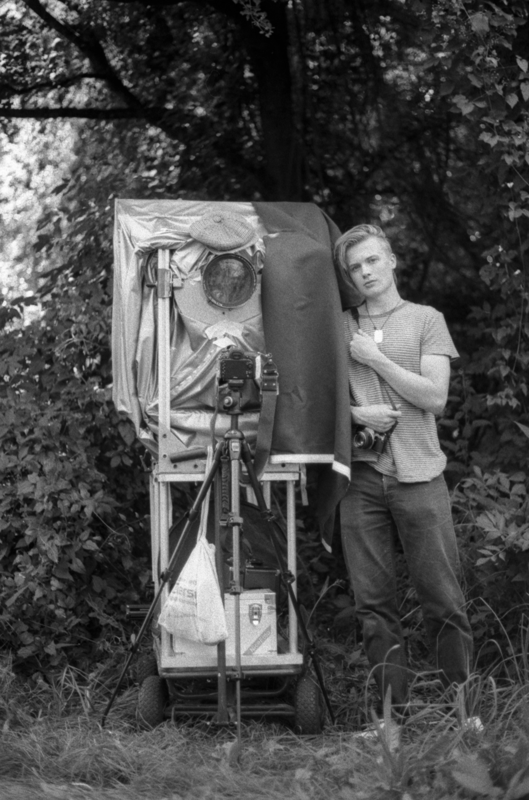

A bit of time has past since this post, but i hope you are still active on here. I am currently building an Ultra Large Format camera, for analog and digital photography, and videography.
this is me next to it. it has a 80x 80 image plane that i take photos of with a tilt shift lens thus getting Ultra large format look on a tiny camera. The thing is that i want an anamorphic adapter for this camera to get more dreamy characteristics and interesting look. especially because in its current state its a 42mm 0.36 equivalent and i want to enhance the special look even more. Do you have any idea, how i could make an anamorphic adapter for this thing. 15cm diameter in front. It is a 914mm f8 lens . I would love to hear any tips. It would be awesome if i dont need to put millions on the table. Maybe resin printing would be an option?
