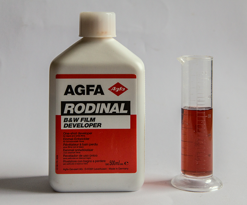

I recently bought the illustrated bottle of 20+ years old Rodinal. I get the age from it coming with an instruction sheet listing times for Panatomic-X and Ilford PanF (not the Plus version). The contents were measured as 500ml, equal to that specified on the container, so it was probably unused.A film was developed in it diluted 1:50, it works like new.The graduated cylinder contains Rodinal concentrate from the Agfa container.
From the pic, the color is still light for Rodinal, showing that after 20+ years it has hardly oxidized.
Seems the manufacturers plastic bottles do a good job in keeping out air and preventing oxidation, at least in this case.

Agfa was aware of the difficulty involved with using a container other than glass. The solution was a composite bottle comprised of more than one layer of different materials. On the bottom of the bottle there may be an SPI code of 7 (the number in the little triangle). If not then below the triangle the letters "PE PA" meaning in this case a composite bottle made of polyethylene AND polyamide plastics.
The color of the developer also reflects on Agfa's desire to produce a quality product. Nothing like the tarry- black color of some of the Rodinal clones. Quality product in a quality container.

My Rodinal never got to that colour, I used it too fast :D But even darker and it's still OK,
I use old Rodinal and Ilford dev bottles there's no issues with them, I really like the2,5 litre high density plastic bottles that my lab chemical suppliers switched to for concentrated acids etc. Virtually unbreakable, a thick wall about 1/8th inch way better than the glass Winchesters.
