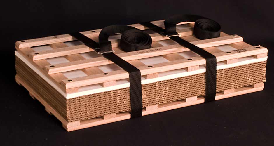

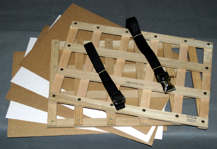

In that line of thought, has anyone tried some off-the-shelf plant dryers like these to dry and flatten FB prints?
They seem to come with a stack of corrugated ventilator and blotter boards in addition to platens and straps with turnbuckles to put pressure on the platens. I saw several online biological supply and plant supply stores selling them. The 12"x18" size is ideal for me as it can fit two 8x10's or one 11x14 per interleaved board. If needed one can insert some polyester interface sheet (like Pellon) in between the boards for extra protection against the emulsion.
Any experience or thoughts?
