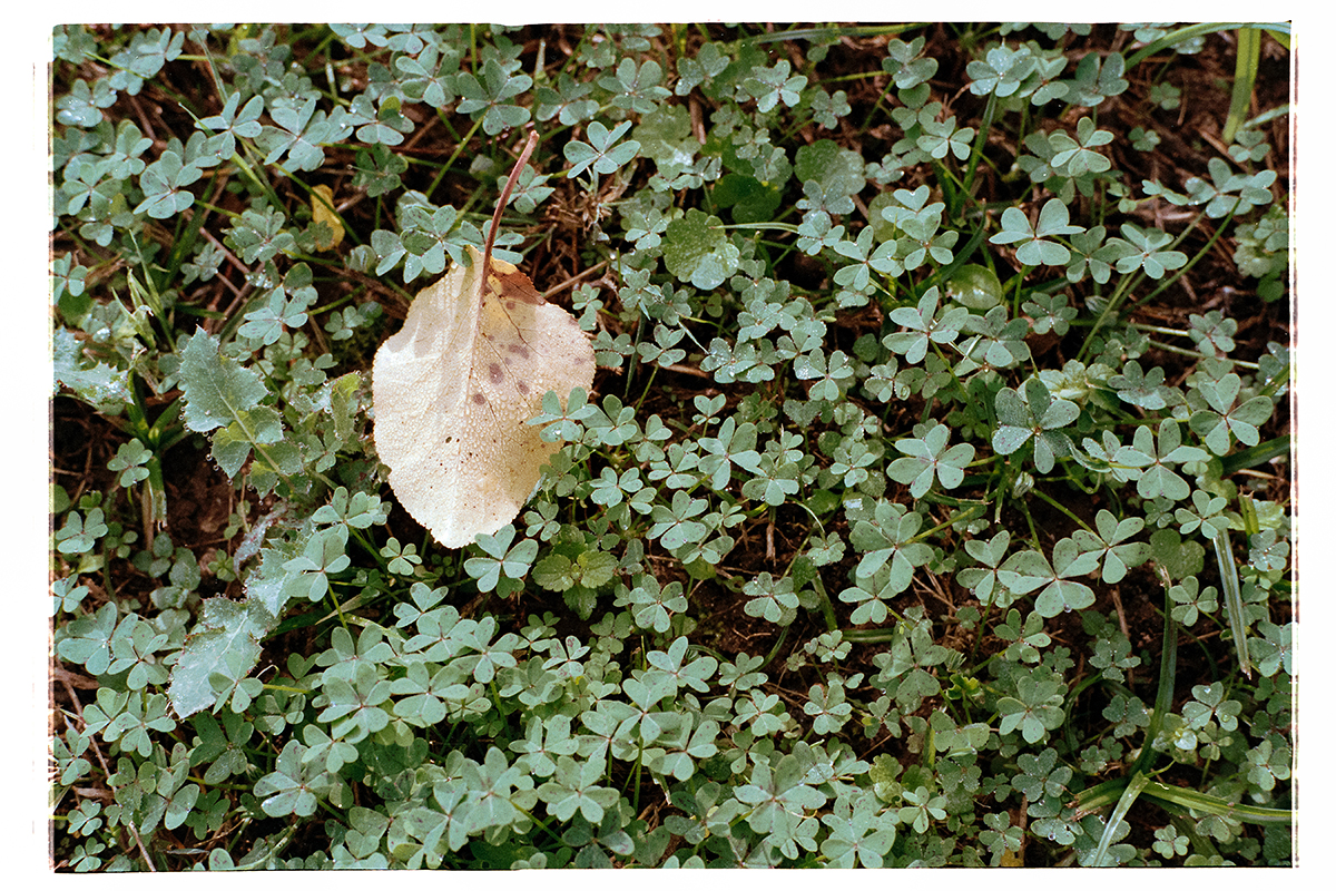

A1) 1/250s @ f/5.6 | Rollei-HFT Planar 50mm f/1.8

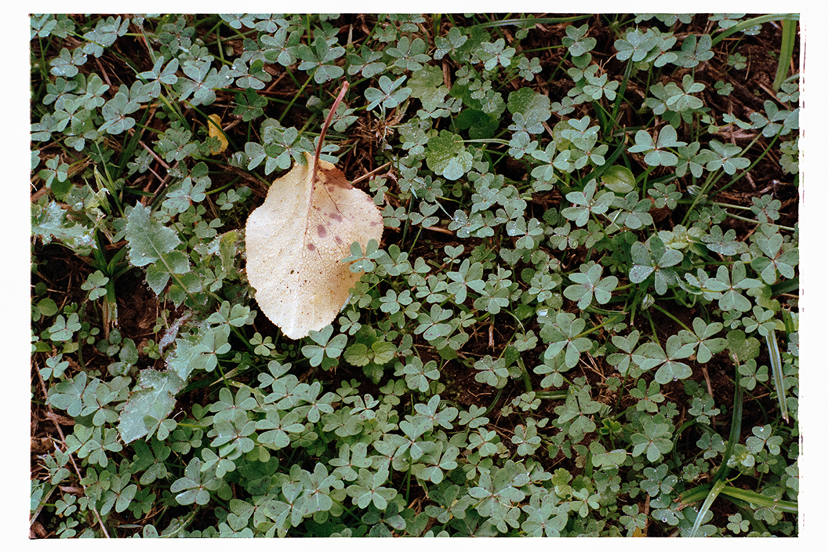

A2) 1/250s @ f/5.6 | Carl Zeiss Jena Pancolar MC 50mm f/1.8

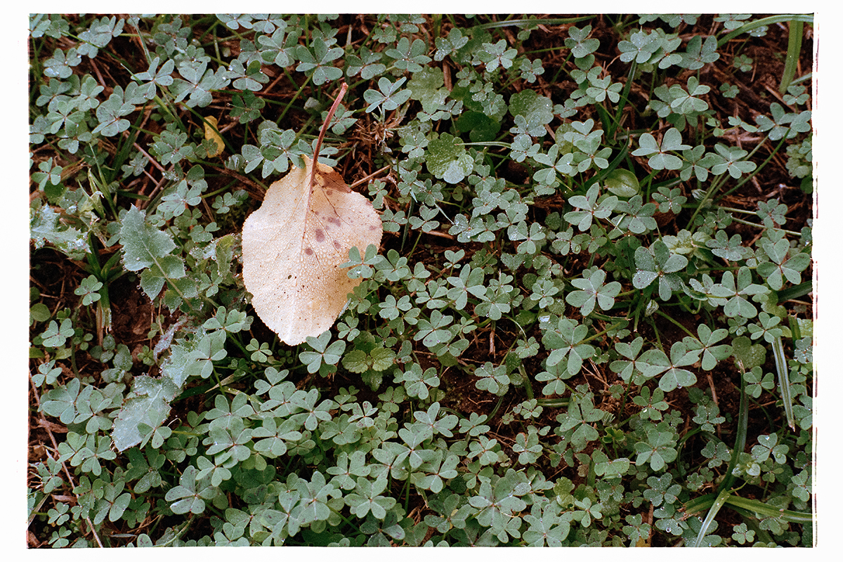

B1) 1/125s @ f/8 | Rollei-HFT Planar 50mm f/1.8

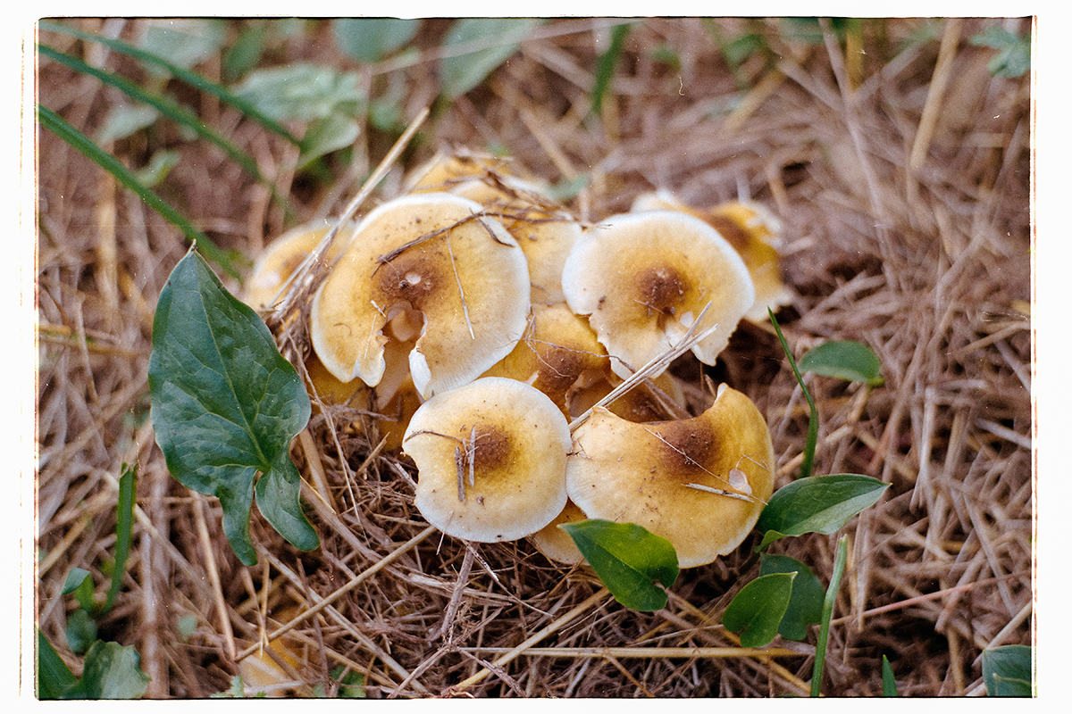

D1) 1/250s @ f/4 | Rollei-HFT Planar 50mm f/1.8
D2) 1/250s @ f/4 | Carl Zeiss Jena Pancolar MC 50mm f/1.8

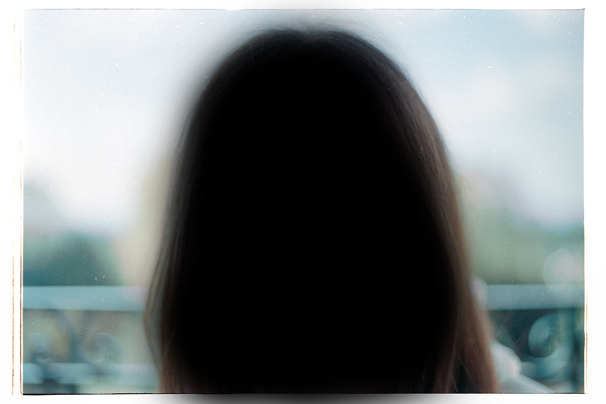

E1) 1/250s @ f/1.8 (lens hood used) | Rollei-HFT Planar 50mm f/1.8 - (obscured for privacy)
E2) 1/250s @ f/1.8 (lens hood used) | Carl Zeiss Jena Pancolar MC 50mm f/1.8 - (obscured for privacy)

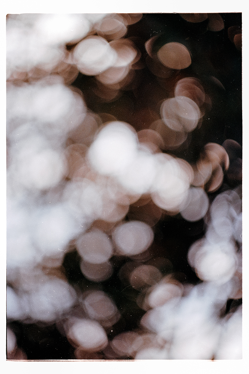

G1) 1/500s @ f/1.8 (focusing at 45cm, lens limit) | Rollei-HFT Planar 50mm f/1.8
G2) 1/500s @ f/1.8 (focusing at 45cm, lens limit is 35cm) | Carl Zeiss Jena Pancolar MC 50mm f/1.8

It is clearly visible that Pancolar has a warmer tone compared to Planar and so, obviously, Planar has a cooler tone compared to Pancolar.
Pancolar has a better bokeh for me, due to the fact that it can focus to 35cm against the 45cm of the Planar; I can also say to you that Pancolar bokeh can be more "swirly", Planar not as much; Pancolar between f/2 and f/3.5 has a ninja-style - similar aperture, (which becomes exagonal at f/4) and in my opinion it helps the rendering of the bokeh.
Planar, indeed, has a better (only very slightly better) multicoating treatment in my opinion, more similar(-ish) to that of modern lenses, which helps in preserving the contrast in backlit scenes (Pancolar do it well, but Planar a bit better), and I think also that this is the secret of that exceptional micro-contrast for which Planar is famous for.
But Pancolar is not to be thrown away: there is something in the rendering of fine details (see picture F2, in the spider web) and also in the highlights transition (not transition between midtone and highlights, but between the darker and the brightest highlights; see E2, F2 and G2; maybe only a personal sensation) which pleases me, and I think that this could be the reasons why, for me, it feels slightly better to see the focusing (a matter of very little or, again, maybe only a personal sensation, which one can, perhaps, feel after a long period of using both lenses).
Of course the tone of the lenses can have an influence on how we feel detail in the highlights and in the shadows.

Seems to me that there are couple of issues at play. In OP's test he is testing for his subjective interpretation, which lens has the most pleasing palette, as far his likes and dislikes go. What we don't know if how accurate either lens reproduce a standard color swab. He used a pretty good consumer grade film, one I use, but not one I would pick for a color test. In the end only the subjective matters, does not seem that OP is shooting a commercial shot where color accuracy matters, such as shooting a fashion shot for a catalog, What he likes is what he likes, I happen to like the Zeiss for most shots, but there are few of frames taken with the Rolli that I would pick as well. Saying that looking at the results does not make me want to run out and get either lens.
The OP has done an interest set of comparison tests, I note that the Rollei-HFT Planar has sharper focus on the corners and IMNOHO* sharper focus in the center.
