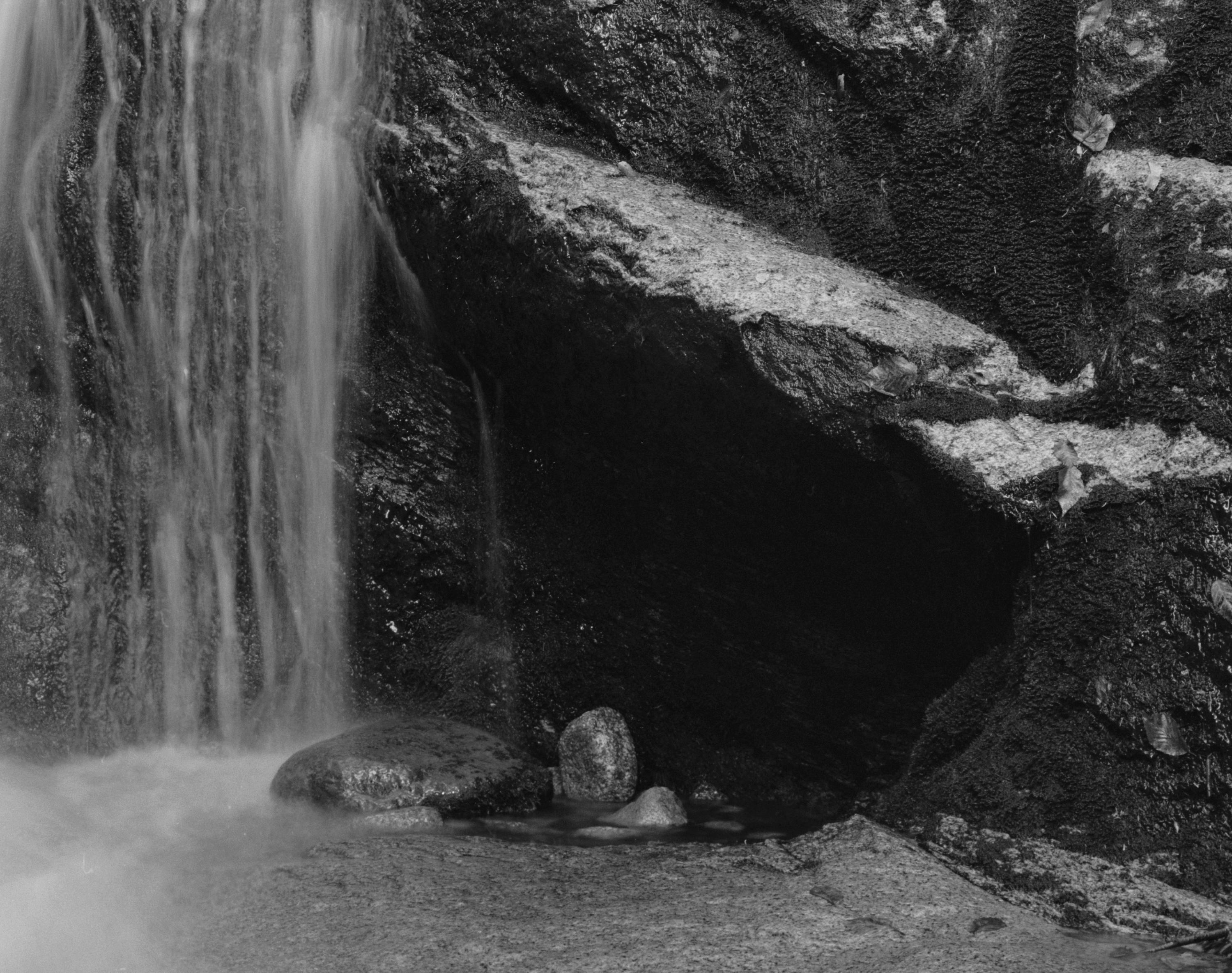

Shadow detail found: just an aside having lost shadow detail. I had my service bureau adjust the scanned image of my Swiftwater falls to bring up the shadows and bring down the hot spot in the top of the falls. I didn't think there was any detail under the right rock, but the scan proved otherwise. There was some waterfalling under that rock (prescient to Bill Burk comment), it looks wonderful now printed and completes my set satisfactorily. Still, more skill and attention to metering and exposure are still the lesson. Here is a crop of that shadow area lost waterfall.jpg
Actually no, the lesson I see here is all about the printing choices and not about the camera/film exposure.
If the issue had truly been a film exposure problem there would be no detail to print, end of story.
Mark, i agree with your correction, in the need to get a negative exposed range to fit on a paper SBR. The printing part i have not gotten to yet, so not sensitized to those challenges and options. This thread and the other one running concurrently "what is exposure index" are two resources now that are my "sticky notes". limitations in dark room are keeping me in contact print mode of my 8x10s. Thanks.
Just wanted to make sure you weren't "chasing ghosts", they are really tough to catch. :wink:
Anytime a third party is involved in the printing of a photo and one has a problem, one needs to ask the printer to try and fix the print before one tries fixing the film, IMO most "negative problems" are actually "printing problems".
