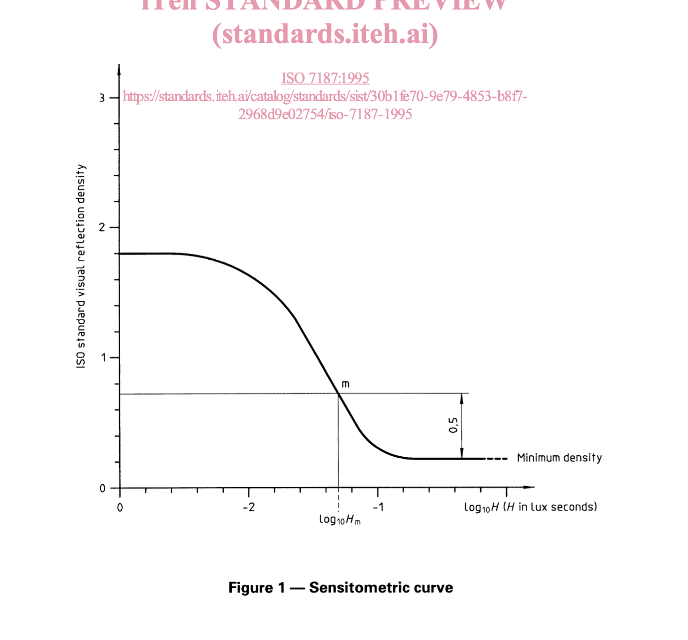

With positive films, if you choose too much exposure for the highlights, you end up with little or nothing usable there, and you can't really fix it later.
With positive films, if you choose too little exposure for the highlights, they come out muddy, the shadows go too dark, and you may end up with little or nothing there, and you can't really fix it later.
Compare that with:
With negative films, if you choose too little exposure for the shadows, you end up with little or nothing usable there, and you can't really fix it later.
With negative films, if you choose too much exposure for the shadows, you can probably work with that, but the highlights may go too dense, in which case you may end up with little or nothing there, and improving on them won't necessarily render the results optimal.
Basically, you place your exposure in order to get things right in the thinnest parts of the image that ends up on the film - shadows for the negative, and highlights for the slide.
Instant photo materials behave a bit like slides.
The speed point is still near lower density (like B&W negative film), however, that lower density represents lighter values.
This is a diagram from ISO 7187 "Materials for direct-positive colour-print cameras -- Determination of ISO speed"
As you can see it is like a mirror image of the H&D curve for B&W negative film.
