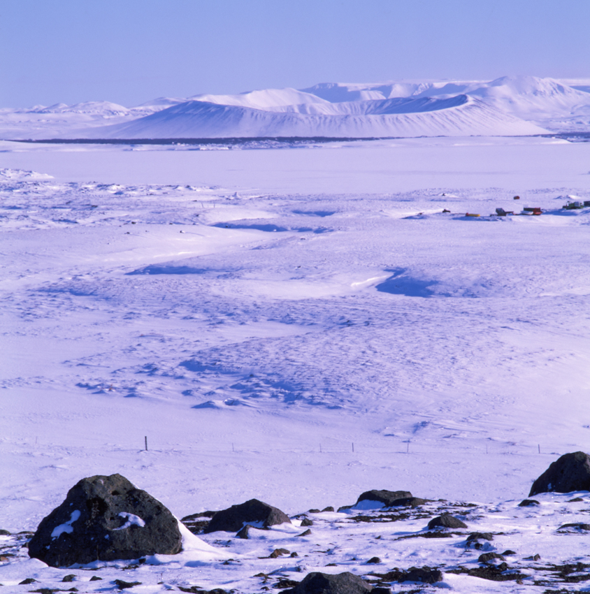

Hi, can anyone explain why the snow in this scene comes out pink? I'm no expert with either transparencies in general or Velvia in particular, so have no idea if this is normal or if I should have done something to avoid it - like use a different film for instance. I quite like the look, but it looks very different to how I remember it!
Thanks
Paul
Hello Paul, this is a bit typical of Velvia. Very easy to fix in Photoshop and other post processing programs. This is a magenta cast, red & blue, which is normal for Velvia under certain conditions. I use nothing but Velvia 50, so, I also like the look, but make changes to eliminate most of the obvious cast. There are many ways to eliminate or bring the cast down to your preference if your familiar with using PS. The simplest is to open a Curves Layer and use the white eye dropper on the snow. It will make a drastic change. You can dial down the opacity of the layer to your preferred look in the end.
Pink snow on Velvia 50 is good. Where was the sun?
This was taken last year so my memory is a bit poor. I think from other shots on the roll that the sun was to the right of me and slightly behind - the shadows seem to back that up too

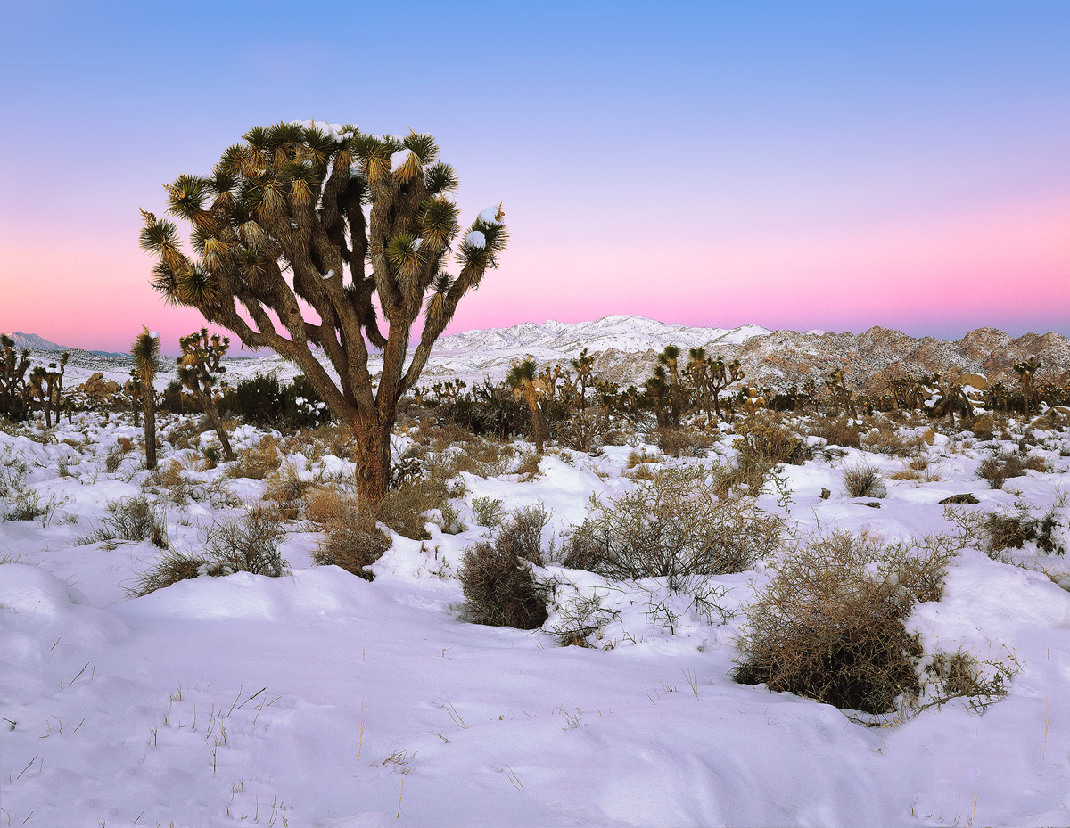

This was 4x5 Velvia 50 image. It had a magenta cast that I changed in PS. There is still a taste of pink in the snow. And, I like the amount of magenta left. The sunrise was directly behind me.

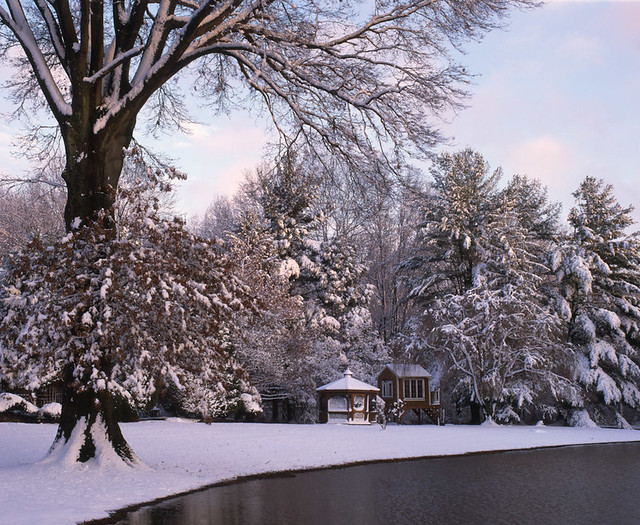

Early morning or evening shots when the sky is turning quite blue can turn your snow into this colour, as will shooting in shadowed areas with bright sun.
If you wait long enough in the evening (or are up early enough in the morning), the Rise of the Belt of Venus and Earth's Shadow* will add an entirely new dimension to landscape shots -- snowy or not, by adding layers of blue-pink-blue, but it looks best in the absence of snow because of the whacky tint it will impart.

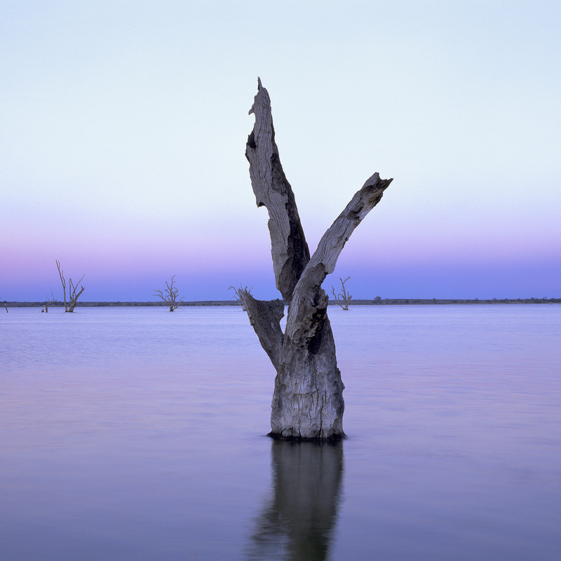

On this image, below, no warming filter was used, and the default circular polariser was jettisoned in favour of a UV(0), as it was considered important to "pick up" and enunciate the soft colour tones a few minutes after sunset (the sun was setting behind me). If this were a snow scene, I would have to make a decision as to the colour the sky would impart onto the snow, and whether this is what I (and potential viewers) would like to see. Theoretically, the pink-blue layer of the sky would come out more blue than pink because that is the nature of the evening light and the way Velvia would record it. Very early morning though and the light would be rendered pink (I have recorded this in studies in the outback in 2011).
