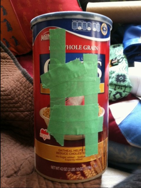

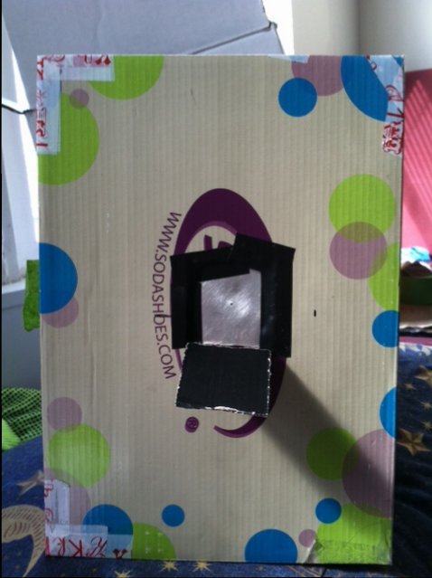

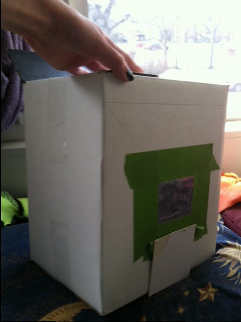

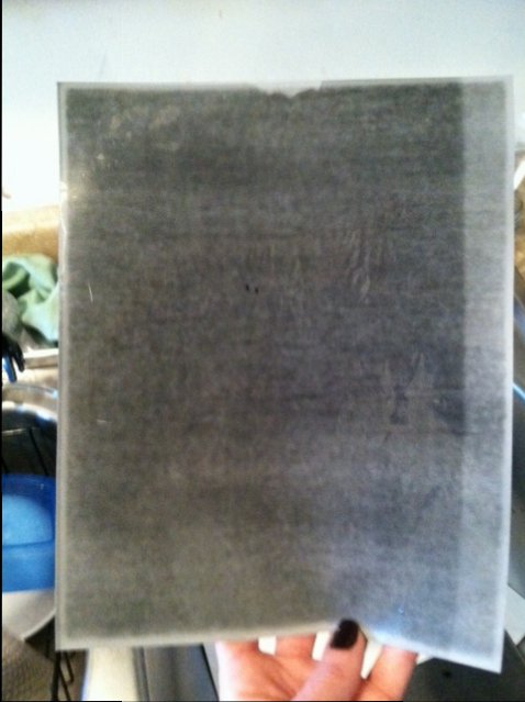

I tried a few different styles in pinhole cameras, one shoe box, a bigger box and a oats box. All three are painted black in the inside and I used a dr pepper can to do the pinhole except the largest box which I wanted to try foil. They were all consistent but when I would develop the paper it would be gray with just the hole. At first I thought maybe the hole wasn't big enough to get an image but making the hole a bit larger didn't do anything. I know the photo paper was in correctly glossy side up. I've made a pinhole in the past but never had this problem.

Photos Of Pinhole Cameras
These the cameras I was using and one of the photo paper that I developed.
Thanks!
Kayla

A couple of things come to mind;
1. The materials your cameras are made from may not be opaque enough. The paper seems pretty uniformly fogged.
2. Is the paper good to start with? Was it loaded properly? To check if the paper is still good, I'd process an unexposed sheet to verify.
3. What's your exposure time? It's possible that you have more than one thing going wrong (i.e., camera leaks light coupled with not enough or too much exposure).
4. I'd also check your pinhole size. Optimal pinhole size will vary depending on the size of your recording media (paper or film) and the desired focal length.
Good luck!
