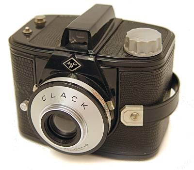

I also use often an Agfa Clack that I rebuild into a pinhole camera. Nice 6x9 format on roll film with a bit curved film plane.
and easy to rebuild.
