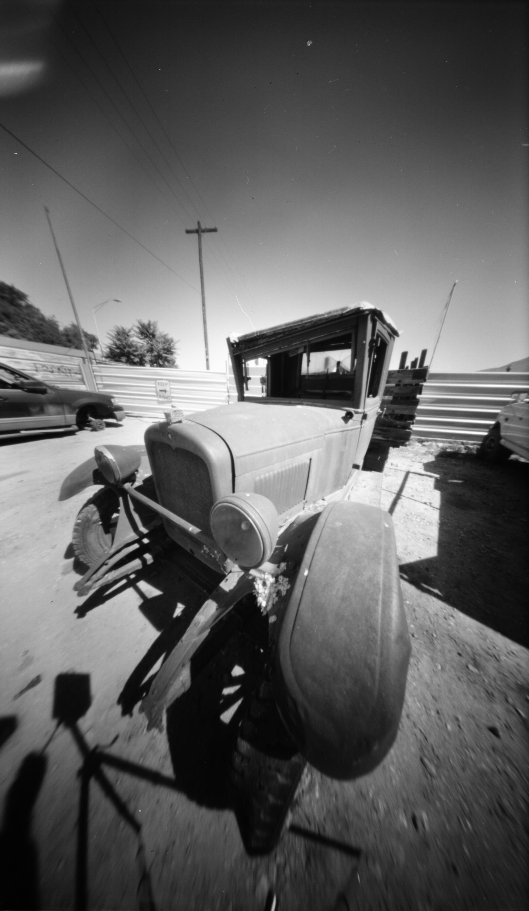

A lot of sharpness is perception -- light, texture of the image, and so forth, but in general a larger format pinhole image like on 4 by 5 can look pretty good, as these things go. Sample, taken with a ZeroImage 45 set for its widest angle of view, so the edges look a bit smeared:
Vastly better than a vasoline-smeared lens, I assure you. Pinhole images on 4 by 5, if the pinhole is well made, can be decently sharp without being over so.

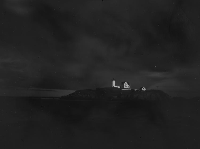

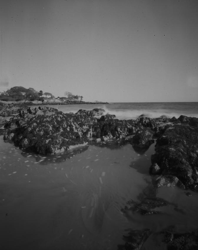

These are 2 of the photos I've taken with the Harman Titan 4x5.
Shot on Tri-X
Shot on the Ilford Direct Positive Paper.
