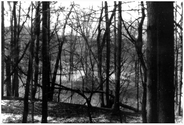

"Once I got reasonably happy with my PH techniques I wanted to share them. That meant they had to be digitized.
Putting a negative on a home scanner with an external light source shining down on it. This is a rather common technique. Unfortunately with 35 mm even the finest scan resolution available to me (2400 dpi), would show scan lines when enlarged to view on the monitor. I switched from 35 mm to 4x5 film which help considerably. Still, occasionally I still could detect some scan lines.
I watch a video on converting 35mm slides to digital with a light board and a digital camera with a close up lens. After making a light board I found I could buy and 9"x12" board used for artist tracing for $13.00, all I needed was a white sheet of plastic to defuse all the tiny little led lights. It is more uniform and brighter than my home made board.
This image is from the scanner.
scanner-jpeg.273680
This image is with the Light board. Using the digital camera has far better resolution and contrast.
light-board-jpg.273681
This photo was taken in the woods on a sunny day, at with 200 ISO film and f360 for 60 sec.
I just thought I would add to the tribal knowledge of the board.
Have fun"

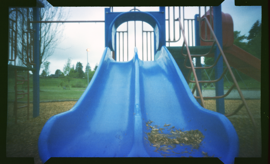

For illustration, here is a before and after example, taken from a roll of ancient Kodak 120 Vericolor film exposed in my Noon 6x12 pinhole camera set to 6x9.
The first is an image as it came out of an old but functional consumer grade Canon scanner, resized for posting here:
The second is from the same negative and same scan, with appropriate digital corrections applied.
Any and all sharpness and image fidelity is present in the original negative. I would suggest that if you are going to display it digitally, it is reasonable to reveal what is there.

With apologies to Ron, I took his "bad" version, and applied two corrections to it:
First, I hit the "auto contrast" button. The contrast in the original image was a bit low. Secondly, I applied a slightly different sharpening technique that I've become very fond of when scanning film negatives, ie "frequency separation". In simplest terms, you separate the image into two layers-- edge detection to get details, and Gaussian blur for the color information. You then blend them back together to produce a single image-- but by varying the amount of blending, you can alter the amount of sharpening (or softening).
In Affinity photo, you can control how strong the split is visually.
The end result is you can decide what detail level you want to sharpen-- one of the risks when sharpening a film image is that you start sharpening the grain. This technique avoids it.
