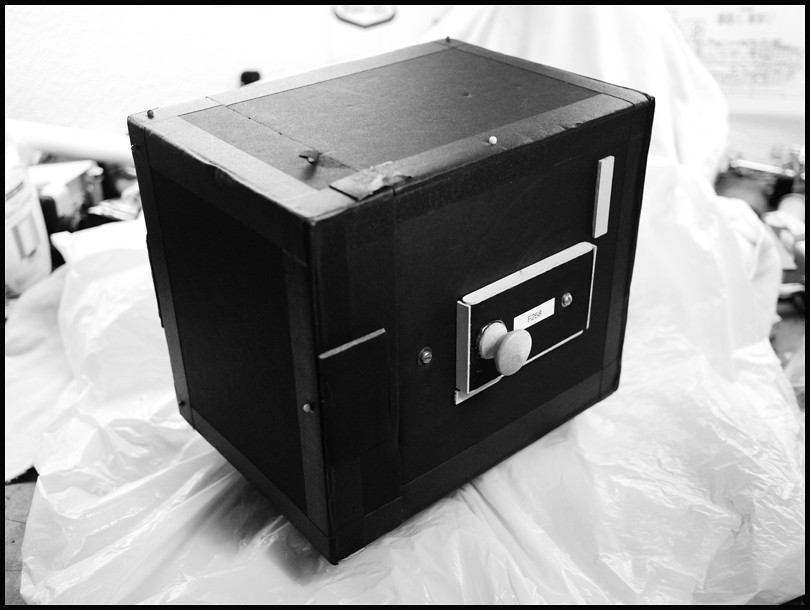

I thought some of you might be interested in this 8" x10" format pinhole box camera I made a few years ago, constructed from black foam core board, black gaffer's tape and built on a heavy wooden base. It's principal feature is a side-opening lid and storage compartment behind the film plane for additional sheets of paper negatives. A movable divider (just a piece of thin cardboard) serves to divide exposed from unexposed sheets in the storage area. There's enough room for over 100 sheets of paper, enough for weeks of shooting while on vacation and away from home.
The camera is used with a changing bag between exposures to swap out the paper.
P1100812a by Joe Van Cleave, on Flickr
P1100814a by Joe Van Cleave, on Flickr

Is the camera made from foam board? It rather Looks like corrugated cardboard. Or maybe extruded hollow plastic board.
In case it has cardboard outer, did you varnish it?
The camera body is made from two layer of foam core board, which was done so the lid would slip onto the inner layer and form a light-tight seal. In the past I've tried spraying varnish onto foam core board in an attempt to make it water proof, but what happens is the varnish soaks through the outer paper layer and delaminates the paper from the inner foam core. What has worked is to use thin laminate board, the kind one applies to kitchen countertops. Also, adhesive plastic shelf liner works okay, too; one of my other cameras uses aluminized film over foam core, although it can bubble up in spots, especially if the foamcore flexes underneath; hence why two layers is a good idea.
~Joe
AgX: I can see where it looks like corrugated cardboard - the inner foam core often cuts irregularly unless you're using a very fresh blade in your hobby knife. But the box is lightweight and strong, and light-tight.
~Joe

Thanks for posting that Joe. Looks like you have beat the size/weight/price limitations that normal 8X10 DDS holders would impose. What size changing bag is necessary for this set-up? I think the one I have would be too small. One of those spring loaded tent style should work well but of course are quite expensive. Still, a lot cheaper than a bunch of regular 8X10 film holders. I'll add my voice to others who appreciate your posts, they are always a treat.
I use a "large" changing bag, purchased a few years ago from Freestyle Photo, I don't recall the exact dimensions.
I put the camera into the bag with the side-opening lid pointed up, then zip up the bag. I hold the camera and bag either on my forelegs while seated, or pinched between my legs. Then I insert arms, remove the lid and stow it vertically along the side of the camera facing away from me. Then I have room to pull out the exposed paper, stow it in its slot and insert a fresh sheet. Reverse the procedure to close it up.
Yes, a changing tent would give you more room; but then you have to figure the setup and tear down time involving the tent itself, which only makes the operation more lengthy. A large changing bag seems to be a good compromise between complexity, cost and convenience.
~Joe
