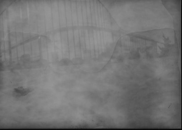

Thanks all you guys. Here is what I have come back with. I tried agian yesterday... I scanned the negative and inverted using PS.
I know this is no where near to perfect, however, here is for you to view and comment it. I think, there is still some light leak or some issues in the picture.
Thanks
Elangs.

Forgot to mention... this is picture of the swimming pool. The things that are shown up here are the rails in the swimming pool... :smile:

This looks very mottled and I suspect part of that could be the result of a light leak through the camera material or exposing through the wrong side of the paper as mentioned earlier. But, it appears to me that the development is also very uneven and I suspect that much of the mottling is coming from poor development technique. How long was your development? Also, it looks like there is a development line meandering through the image from not immersing it in developer quick enough. Be sure to give the image full development with constant agitation.
Is the paper you are using outdated? That could be another factor in the overall grayness/fog and mottled appearence.

Ok - call me a wierd nut, but....that almost looks like multiple, enderexposed images to me.
I can see a wrought iron fence if I look hard enough and once I am told what it is supposed to be, but what I see first and without suggestion, is a bridge in the upper half of the photo, and a face in the centre, with the mouth in the bottom centre.
Below the bridge and in what looks like a background is a cityscape?
Oooh - I gotta see what I put in my coffee this morning......

Looks like serious fogging to me. You never said what the material you made this from was. Was it card board or metal. I would spray both flat black in side as, if I remember the inside of the one metal oatmeal tin I have seen it was a copper color. Copper will reflect light and have it bouncing all over the inside of your camera.

I'm in agreement here -- the long curved line across the sheet, especially, is almost certainly due to getting into the developer unevenly. Also, is it possible you pulled the paper after a lot less than the full development time (typically 2 minutes in Dektol 1:2, 68 F)? That will give a muddy appearance, where the shadows (or in the case of a paper negative, the highlights) aren't fully developed and are gray instead of black. And you have a lot of fog -- for which others have made good suggestions.
The mottling looks very much like an effect I once saw when trying to contact print paper to paper to get a negative print, caused by variations in the density of the paper and/or the reflective backing behind the emulsion. Is it remotely possible you could have exposed the backing side of the paper, instead of the emulsion side? Under safelight, most papers are glossier on the emulsion side, but a few matte surface RC papers are actually shinier on the back...

You are right.. this is a iron rods - around the swimming pool. in the bg, you see some bush and apartments doors.
Also, the oatmeal box is cardboad box. which is spray painted inside and covered with black contact paper. The lid is spray painted and on top a black paper taped. Still dont know where could be the light leak...
About the back side of paper ... I m going to do a test on it, maybe this week end.
