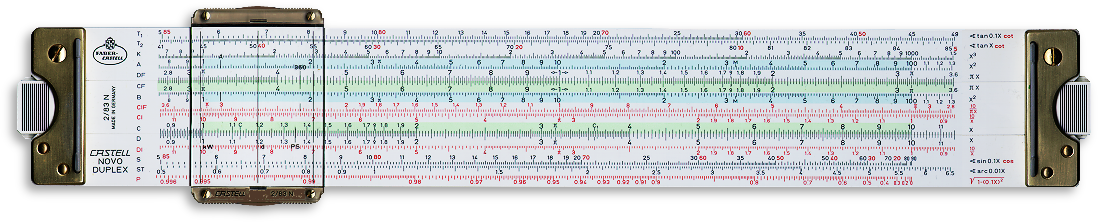

Lol. I actually have a pretty valuable collection of slide rules I've collected over the years...some of
them are works of art...beautifully made with Bamboo...as smooth today as 60 years ago. By the
mid-1970's, the electronic calculator had all but replaced them, but when I was in high school, my math
teacher said "Any good man worth his salt should know how to use a slide rule", and he forbid the
use of electronic calculators, so we were all pretty awesome with them. :wink:
They even have an iPhone app. The one picture above is a Faber Castell 2/83N...goes for big bucks...
the Leica of Slide rules.

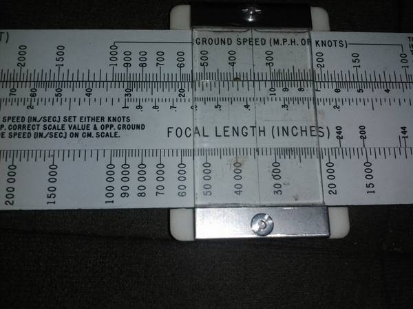

Darn it...did we answer the OP's question on DOF before I took us off the rails talking about slide rules? lol
The U.S Air Force had these special slide rules for aerial photography...
Yeah, the OP's question was answered before we started talking about slide rules. :smile:
Slide rules used for aerial photography, huh? Now that's interesting!

Ya, although I've never seen one, they appear to be about focal length selection, altitude etc...I'm assuming it would have been
for the purpose of optimizing resolution?

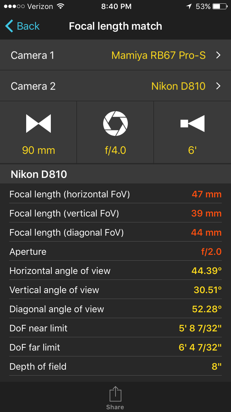

You guys should all get this app for iOS called, "PhotoPills." It was super fast for me to compare the DOF and angle of view to many other cameras, including custom cameras I created for this very purpose. There are lots of other goodies that you'll have to see for yourself, too. As some have implied, the equivalent DOF would be f/2 on 135. 2016-04-19 20.40.56.png
