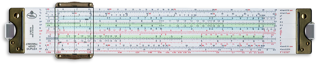

Lol. I actually have a pretty valuable collection of slide rules I've collected over the years...some of
them are works of art...beautifully made with Bamboo...as smooth today as 60 years ago. By the
mid-1970's, the electronic calculator had all but replaced them, but when I was in high school, my math
teacher said "Any good man worth his salt should know how to use a slide rule", and he forbid the
use of electronic calculators, so we were all pretty awesome with them. :wink:
They even have an iPhone app. The one picture above is a Faber Castell 2/83N...goes for big bucks...
the Leica of Slide rules.
