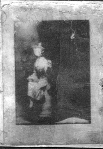

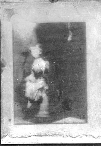

Hello to All,
Since some of my sugestions have been tried by participants in this Thread, with very negative results, it has occured to me that some might think that I am "full of It". So, here is a set of B&W in-camera color separations that I was Able to scan against a black background.
Here is what I did: Heat treated 10 grams of rosin,
Disolved it in 500 ml of denatured alcohol,
Added 500 ml of Water,
Dip coated 4 clean 5x7 glass panels (both sides)
Dried verticaly overnight,
Exposed via sunlight for 3 houers,
Developed over Sunnyside Odorless Paint Thinner,
10 minutes,
Let dry.
Scaned each with a flatbead scanner against a black background.
Regards,
Bill
UH-OHH! My images do not have a URL They are just files in My Documents. Anyone know how I can get them here?

Now thats an idea Dip coating, both sides ? did one side stay frosty ?I see you have used a 50/50 mix, good pics, how do they look just held up to the light ?

Hi bruce,
Somehow my response to your last post did not get "published".
Glass plates develop cleanly on both sides. I turn over the glass after 5 minutes, midway through my standardized 10 minute development time. But, honestly, I think that development is complete in less than the first 5 minutes. I like Oderless Paint Thinner becausae it is nearly impossible to over-develop.
Held up to the light the plates have a clear background (black in the illustrations, The image is a pearlesent, off- white.,
Regards,
Bill
